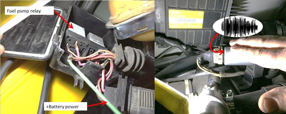

When turning the ignition on I can hear the fuel pump relay switch and the pump buzz for a couple of second. That’s correct as I understand it; the engine must crank to allow the pump to continue.
There is voltage from the ignition (15) to the relays and the power relay has voltage at 87.
When cranking the engine no power is going out from the relay to the fuel pump. No ground from the ECU or no voltage from the idle stable control?
I switched the ignition on/off some times until fuel came to the breather in the T-junction. So the pump is functional as I see it.
Connecting the fuel pump direct to the battery voltage makes the idle stabilizing valve vibrating.

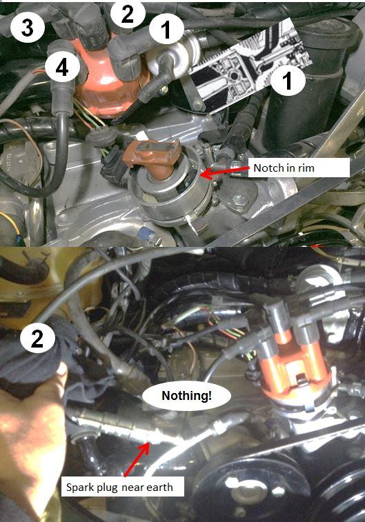

Checking for spark was a disappointment. Nothing to be found. I made sure the distributer and cables were correct mounted.

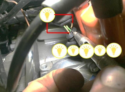

I then put a steel wire in the middle terminal in the hall sensor connector on the distributor and touched it against ground. A proper nice spark appeared between the cable from the ignition coil and ground. The coil should be OK.
There is voltage between the two outer terminals at the hall sensor connector. When cranking the engine there is a pulsating voltage at the middle terminal. He hall sensor should be OK.

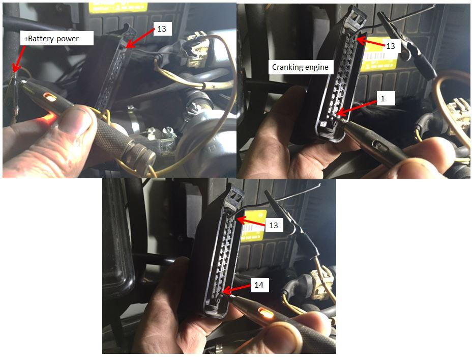

I started to check the input for the ECU.
1. No voltage. I have not connected anything to the solenoid at the starter. Which cable/terminal is that? Must go through the schematic.
2. The pump runs when bridging. OK
3. Voltage at 14 but not 13.

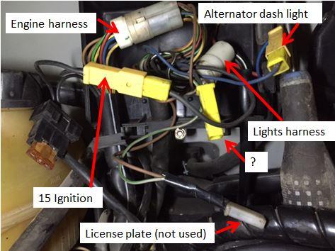

Two wires I did not find anything to connect with. Behind the alternator.
Another wire that puzzle me. Red and black.
1. Starts at the idle stabilizer
2. Enters the fuse box
3. Leaving the fuse box
4. Merge with another wire and leaves the connector
5. Enters the coupling box
6. Leaves the coupling box in the harness that goes to the dashboard in the front of the vehicle.
How should it be connected there? 30, fuel enrichmnet when starting?

I am not sure if this test is valid on the 2.1, but with the key in the run position you should be able with a 12 volt test light grounded operate the coil by tapping the outer pin, then the middle pin and then the opposite outer pin of the distributor harness with the testlight harness unplugged. If the coil fires with this test, I would be suspect of the Hall effect or the wiring of the hall. If you look closely inside, I have seen the shutter wheel accidentally damage the wire in the case. Excellent documentation.

I have now done some more testing on the connector to the ECU.
Terminal 13 seems to be ground when tested to battery power. Ignition on.
No voltage between 1 and 13. Ignition on. Cranking engine.
Voltage between 13 and 14. Ignition on.
Checking voltage at the connector for the third cylinders injector. No voltage when cranking engine.
I see that I have one yellow connector with nothing connected in the connection box. Black cable. A component missing signal for ignition on? Must be investigated.
To answer my own question; the red/black cable at the idle stabilization control unit must be for terminal 50. At the ignition switch or starter.

Pretty sure your two mystery wires go to the back of the power steering pump.

Yes of course, it must be the two cables to the steering pump. I don’t have a pump so I can leave them out I assume.
I connected the red/black cable to the starter (terminal 50) but that did not help at all.
The black cable in the connection box was in fact black/blue which must be for the backup light. Can be left out in my case.
At least I now have all the cables identified and connected as it should now, I think……..
