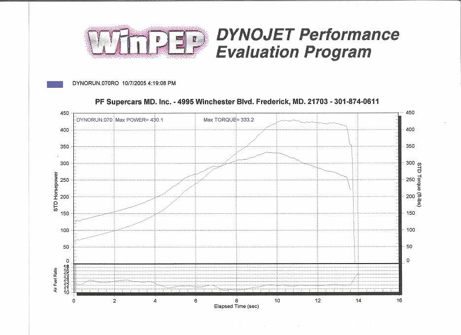

1993 RX7 pT-67 .81 a/r
1308cc Two Rotor motor
430rwhp@16psi
