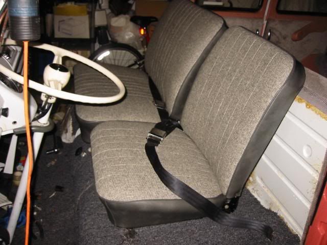

Seat Frame:
The carpet (still have leftovers) prevents the springs from poking thru the sponge
Using the wifes blowdryer to heat up the material (shhhh)
Hog ring detail
View user's profile Send private message Facebook Twitter Gallery Classifieds Feedback

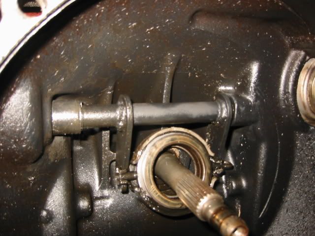

With the engine out I noticed one of the clips that hold the throwout bearing in place was broken and possibly bouncing around in the bellhousing.
Broken clip:
Throwout bearing hanging in there:

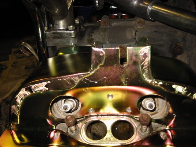

One of the problems I had with the engine was an apparent lack of cooling, so I wanted the engine tin to be in tip top shape and as unadulterated as possible from OG design.
The tin that was installed was hacked for a type 4 oil cooler, so some key parts were custom fit, and others would not fit. So I had to get new tin.
Here I am modifying the cylinder tin to include a little deflector that is often missing from aftermarket tin.
I drilled it out from the aftermarket tin that was on the bus, and riveted it to the new Scat cylinder tin.
Test fit

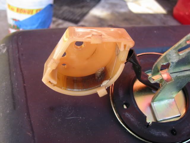

Engine is out, so I took the change to remove the fuel tank to repair the sender, and give it a good cleaning.

I found out why the fuel gauge was not working. Not only was it not the correct bus type sender, it had a bad spot that would cause erroneous readings. (I ran out of gas twice due to the faulty fuel gauge.... Wink )
Look and you see some melted plastic running over the strands of wire that cause the impedance to change to give a gauge reading.

Cleaning up the engine bay...
I got some straps from a parts bus at JB Bugs in Jensen Beach, FL. Thanks Paul !
Time to get rid of the plumbing straps...
