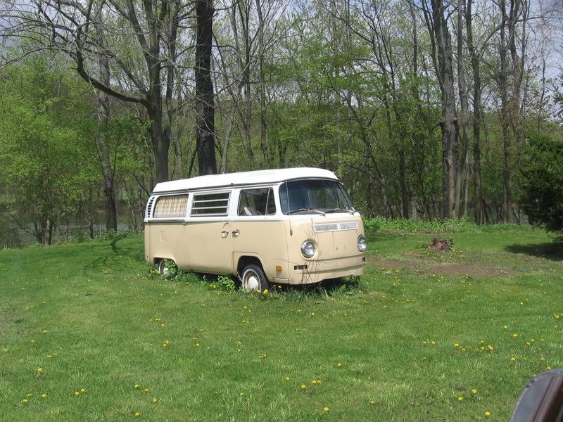

Here it is loaded for the trip up...

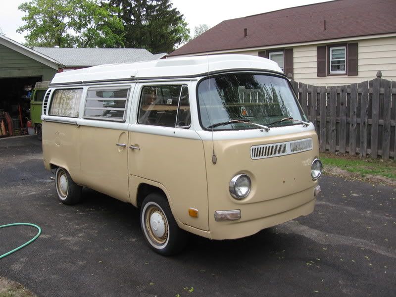

The Bus in some happier days:
It's going to be fun to drive it again! It's always been a great running van and having it back will make for a much better summer.
