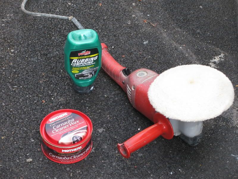

What are you using to buff that? It looks great!

That looks great! I am curious to know your methods/products as well. How are the part sales going? It seems everything has slowed considerably right now...

Yeah, what's the buffing secret??? Would love to do that to mine and my Beetle.

And ditto. Whats the buff polish secret? Rubbing compound, and ????

As far as what I'm using to buff it, I have a Milwaukee variable speed buffer (NOT a grinder, there is a difference) and I'm using a wool pad with a rubbing compound I actually got at Wal Mart made by Turtle Wax. I usually buy my compound at an auto body supply store but I was in Wal Mart and saw they finally carried a liquid rubbing compound and decided to give it a shot. It's worked pretty well I have to say. For wax, I'm just using a Mother's Gold Cleaner Wax once it's buffed. The results speak for themselves.
