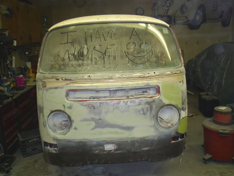

I think she's turning green. Definitely more green than earlier:
but definitely getting better!

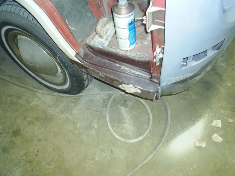

tonights progress:
drivers floor welded in. not crazy for the fitment, it needed some tweeking, but holy hell is that a rugged piece of steel
nose in primer. i still need to sand out the headlight buckets and the air vent. the belt line still needs to get stripped and the bottom needs some finishing off.
still need to takle this

the lower nose section was put in by someone else. i didn't realize the extent of how much was missing on the back side, so i made the corner pieces tonight. i need to weld up the dogleg but once in place, it has a really tight edge with the nose. kind of hard to tell in the pix
the vertical part is nothing more than a semi curved (dam near straight) piece of metal. the drivers side looks about the same

dogleg fitted and done. let me just say klokkerholm stuff really just plain sucks. i know they are one of the few that make them, but they took a lot of fooling with to get right. also, there is no nut plate to bolt the bumper to, which took more time to do. speaking of time, i have about 80 hours into this so far Shocked and have at least another 10 or so to go. anyway, on to the pix
first coat of POR-15. i really wanted to put some gussets in the dog leg, but after 3 tries i gave up. it was very difficult to judge how much room there is inside the box. the inner part was already tack welded in a few spots, and was pretty well aligned, so i didnt want to re-do too much of what was done. don't let any heavy heifer's jump up and down on the bumper Razz
and got the nose in a good coat of fill and sand primer. i have a few spots to take care of, should only take a few hours. not too bad considering the work
im friggen beat. going to bed. stay tuned, more to come
