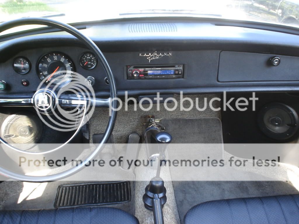

914 speedo diddnt fit my 71, too small
I ended up painting up my stock speedo to match, looked alright

Was it a bitch to take apart? But it looks great!

it takes a bit of patience to pry off the chrome ring, and make sure you replace the needle i nthe exact same spot when you reassemble, or it will throw off your calibration.
btw type 3 speedo is the right diameter, you just need to grind off the mount tabs in the back because they mount differently.

CLKWRK- what kind of cd player is that? I am looking for a CD player that will not require any dash modifications.

that is a sony xplod deck, i does not fit in the original hole , I had to mount it from the back with a fancy bracket I made.
I am not using it anymore as I did cut my dash for my 911 gages
