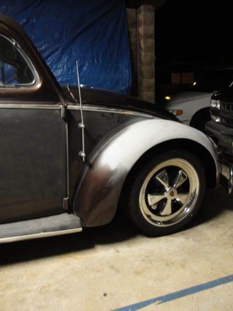

PostPosted: Tue Dec 15, 2009 8:48 pm    Post subject: work in progress Reply with quote
Just got back from working on the car, mounted the fuchs using adapters for now, trying to figure out how it will work!
