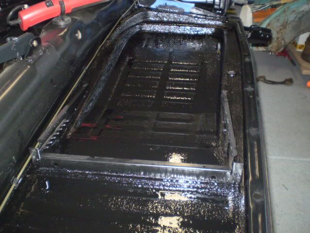

I got the front brakes complete and put down some herculiner on the pan..
First I had to sand my new powder coated pan..
I put it down thick so I could cover up the ridges on the pan, apparently this is where the moist accumulates.

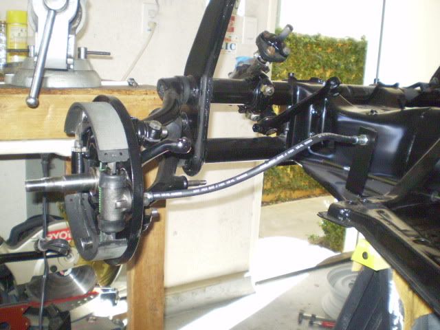

PostPosted: Wed Dec 23, 2009 3:37 pm    Post subject: Front End Reply with quote
Today I got my King/Link pins in and installed the front brakes.
Here's a picture of the front end and half of the pan.. I'm going to put down some more Herculiner and then a tar mat to give it the original look...

PostPosted: Tue Dec 29, 2009 7:04 am    Post subject: Re: Front End Reply with quote
artmolina wrote:
Are you sure you got the correct length brake hoses? It looks to me they'd be too short at full lock...
83_WabbitGTI
Joined: December 01, 2006
Posts: 1325
Location: Eagle Point, Oregon
83_WabbitGTI is offline
PostPosted: Tue Dec 29, 2009 7:35 am    Post subject: Reply with quote
I was thinking the same thing. Turn the wheel to the right and it looks as if it would pull.
2009-2010 Vice President of SOVW www.sovw.org
"No matter how a VW breaks down.... You can always make it home on Zipties, Ducktape, and JB Weld...."
-Doug Christen, VW Owner
83 Rabbit GTI - 83 Rabbit LS Custom - 63 Westy - 65 Bug - 64 Baja (Herbie's Studly Cousin) - 91 Audi 90 Quattro 20v
Need a VW website built? PM me.
artmolina
Joined: November 27, 2004
Posts: 128
Location: Temecula
artmolina is offline
PostPosted: Tue Dec 29, 2009 8:47 am    Post subject: Reply with quote
Might be an optical illusion. It does look like there is not enough room. I double checked them when I put them in. There is enough room.

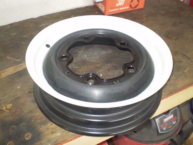

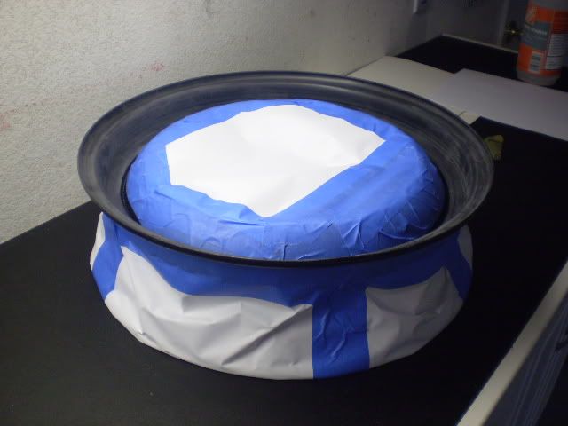

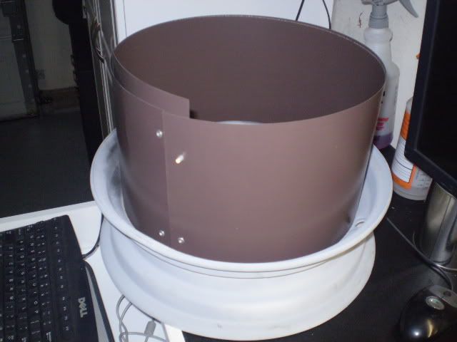

PostPosted: Mon Jan 18, 2010 11:46 am    Post subject: Getting ready for paint.. Reply with quote
Here is a rim almost ready... I'm going to go to Home Depot and get some aluminum sheets to make a cylinder so that the paint does not get on the center of the wheel... I'll post a picture so you can see what I'm talking about..

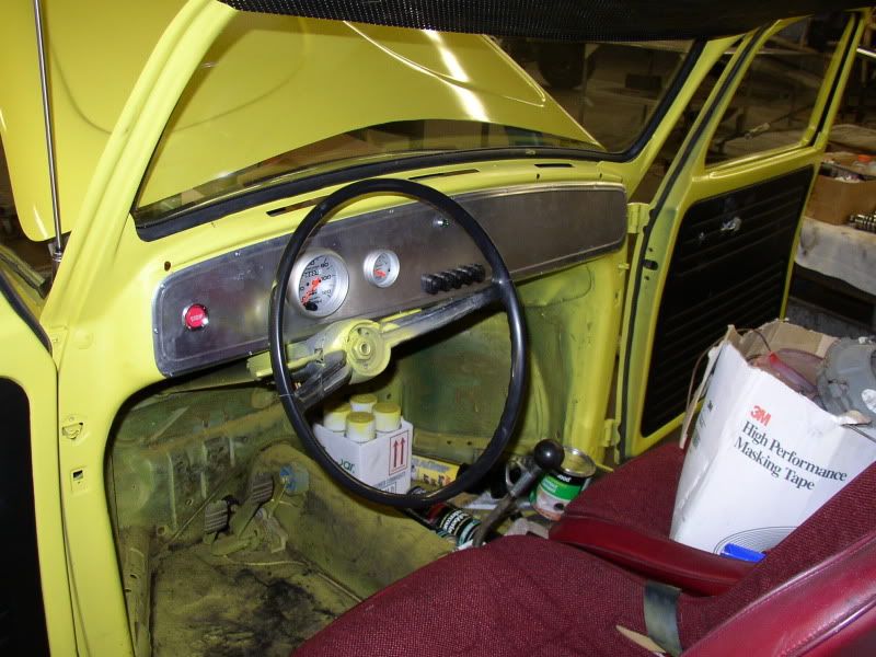

1914 I put together...
Diamond plate fire wall came out pretty good.. Looks good with the motor too..
Simple dash with a honda push start button and some switches..

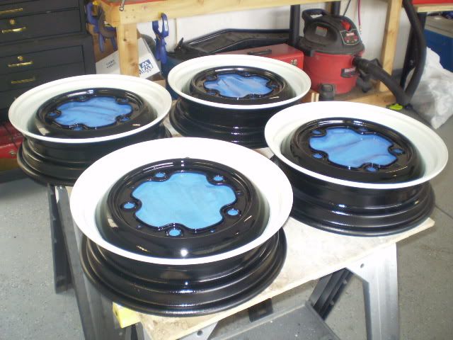

PostPosted: Fri Feb 19, 2010 2:13 pm    Post subject: Painted Rims Reply with quote
I'm ready for clear coat..
artmolina
Posts: 128
Location: Temecula
PostPosted: Fri Feb 19, 2010 3:22 pm    Post subject: Reply with quote
Rims With Clear Coat
