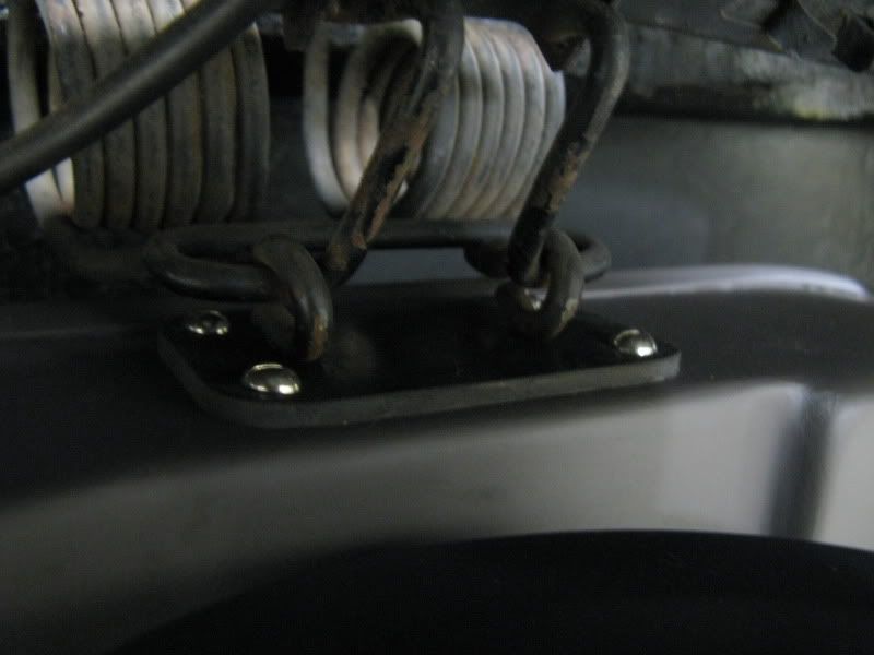

little rubber pad i added, keep looking to see what it's for.

the little rubber pad. since this motor is from a 70's beetle the tins rub on the decklid spring. not anymore!
