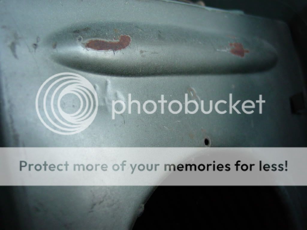

PostPosted: Mon Sep 20, 2010 5:09 pm    Post subject: Reply with quote
Strike 2.
Looks like verts have their own body stamps. According to posts as early as 1962.
Of course mine does not have a stamp in this location.
Any early vert owners have this stamp?

0nebadbug wrote:
0NEBADBUG: Mid Nov 56, Polar silver, Euro Spec Sedan, 44 / B
If I had to take a stab at these marks? I'm guessing quality control reference.. shift, station, worker ...etc...
Kinda makes sense if you think about its random and incoincidental ill-nature of colors, models & reguardless across years being similar and so on...
I am inclined to agree with you. Some of the numbers you see on the early splits are also on the later VW's? # 55 sure is popular, you can see it on Johnhenrys 1950 and all the way up to my Jan 58? I wonder how many "Jigs" VW had in use at the time, as these different numbers could be various inspectors putting their stamp after each car was completed in the jig assembly?

Are these possible mcodes?
Agave58
Joined: March 14, 2008
Posts: 1122
Location: Arroyo Grande California
Agave58 is offline
PostPosted: Tue Sep 21, 2010 8:26 pm    Post subject: Reply with quote
Are you refering to the numbers on the Verts?
1958 Agave Beetle
Stateside Motors Inc
501 Foote Ave
Jamestown, New York 14701
Wanted!!! Stateside Motors Inc, Dealer Frame & Accessories.
AlteWagen
Troll
Joined: February 23, 2007
Posts: 5407
AlteWagen is offline
PostPosted: Tue Sep 21, 2010 8:40 pm    Post subject: Reply with quote
No the stamps on all the sedans.
Maybe codes to help assembly line workers put certain parts on as early as possible during initial assembly?
Take for instance 55, m code 055 is shifter lock with ignition switch. Putting the correct wiring harness during initial assembly would be MUCH easier than adding it later at the dealer.
22, or 022 is for sealed beam units, a different connection is used compared to euro bulbs, and VW sent the headlight units with no bulbs so dealers would install US products before sale.
Just plain 2, or 002 is US equipment.
Do any numbers match m codes provided on individual birth certificates?
I wish it were that simple? My 58 has "B" and "55" but my M-codes are. 067/128/134/350.

Just checked my 60. Number 9 on the driver side just above the inspection plate.
derluftwagen/1960/Feb 60/L41 Black/9

1957 oval:
2003NBC/1957/May 1957/L331 Horizon Blue/"00" on rt & "D" on lft

Those look more like 5 5 to me....
MIke
2003nbc wrote:
1957 oval:
kdf38
Joined: March 07, 2002
Posts: 730
kdf38 is offline
PostPosted: Thu Apr 26, 2012 8:51 pm    Post subject: Re: Mystery Number Reply with quote
Def. not 00. Too short. Looks more like 55
2003nbc wrote:
1957 oval:
Is that.......... orange metalflake?Smile I started this topic 5 years ago and I dont think we will ever have an answer.. but the numbered Pressing Stamp Mills makes sense.

Yea I think it must be 55, I checked the back using a mirror and it looks similar to the photos, but seems 55 more likely. Photos taken at night using a shop light thus the orange glow - actually silver.

1953 zwitter, chestnut brown has single #4 on passenger side inspection plate.

I have the number 44 stamped above the passenger side inspection plate.
Aug '50 deluxe split, L70 medium brown

I posted about these body stamps over in my main thread and there were no answers..........seems on the most part these letters and numbers are still a mystery????
Left Side:
Is an upside down E
Right Side:
Is a single number 5
And the Body Serial 566889 and "European Only" Baujahr Stamp 1957
I don't have a Birth Certificate yet on the car, my educated guess is that the car is from the late May Production and Delivered sometime in early June 1957.
