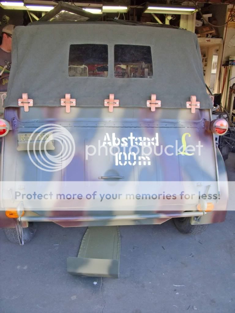

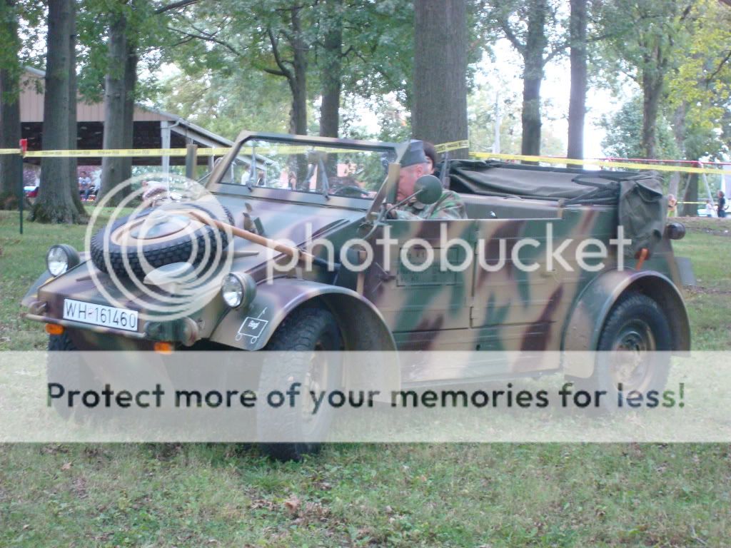

Attached are picts of mine, built by Kooblekar and delivered in mid-September. This is my first air cooled VW since my 73 Beetle I drove in college from 84-87.
It was built on a 76 super beetle pan, converted back to a standard beetle. The motor is from a late 68 Type 3. I have spent the last 6 weeks "de-bugging" it from them. I've had problems with the seat brackets, shifter, and brakes. I think I am finally working through most of these issues, although I suspect it will take another few months to get it dialed in completely.
I strongly recommend the rear vents for the engine ventilation over the air scoop. I suspect if I ever do a rebuild on mine, I will have it changed to ventillation holes on the rear panel. With the top up, it makes it a real screamer. I also need to build a battery box to get it off the rear floor in the open, as well as just tighten everything in the car up. KKSW has a lot of issues, and some of their work is half-assed, at best. I usually bounce between amazement on how the thing was put together, and then disbelief at other things.
