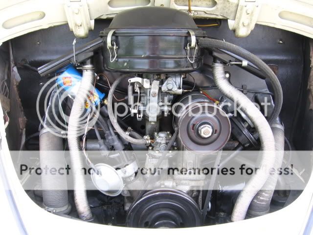

PostPosted: Fri Mar 04, 2011 11:02 am    Post subject: Reply with quote
I don't think a 36hp air cleaner will breathe as well on a 1500. I'd advise finding the '66 cleaner pictured above. It will still look very stockish in the '56 compartment.

PostPosted: Fri Mar 04, 2011 8:32 pm    Post subject: Reply with quote
Is this the 113 129 613 Q air cleaner you have??
Looks like a 1966 AC, but has the post-1967 AC preheat tube. That should work fine and better than a 1966 with your 1600 due to the larger later preheat tube.

PostPosted: Sat Mar 12, 2011 1:06 am    Post subject: Reply with quote
This is the one I use, from a '66 Beetle. It works perfect.
