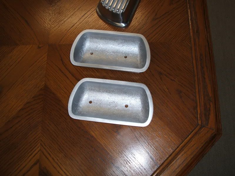

Here`s the two old school valve covers after a fast polishing job. Both fit very well and I also milled and sanded the gasket area just to make sure they where flat if I had a 6" belt sander that would be the way to go. They do have some pitting here and there nothing bad with more sanding I think it would clean it up but there fine as is. I`m thinking of selling these for 100 bucks but in the future I will have to find a shop to do the polishing or sell them unpolished I just don`t have the equipment to do it.
PS. Its Porsch Mark LOL and I think the valve covers are bigger but it could be done but not by me at this time Cool
heres the two new and the old covers.

This is what I`ve been doing for the last year. Its almost sick but I`m 98% there.

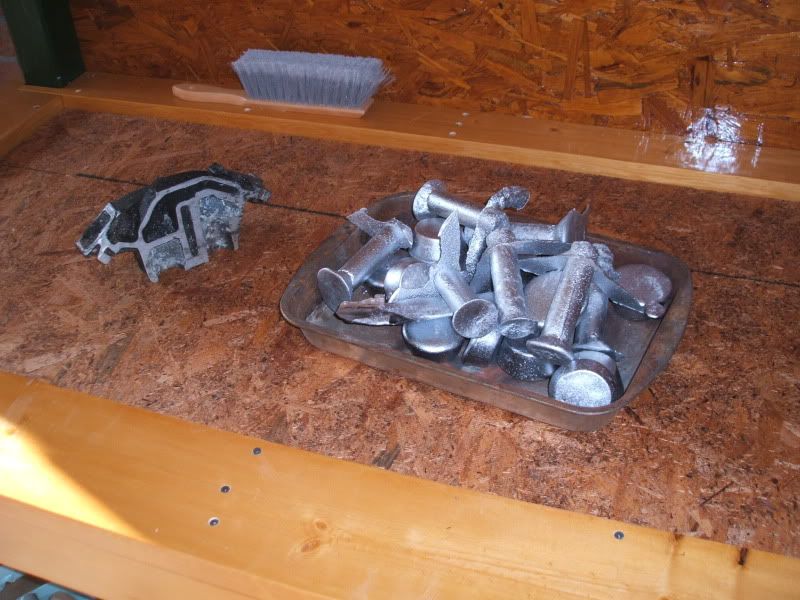

Finished up my molding bench this weekend and now I can give the knees a break. This bench makes it so much easyer to make molds that it`s almost fun night and day from the concert. So just before firing up the grill today for a cookout I give it a try and poured two covers and melted down some scrap for the next ones to come and it worked out great. The bench is lined with galvanized sheet metal and has about 250# of greensand in it with room for more if needed. Have a look Cool

PostPosted: Mon May 30, 2011 9:38 pm    Post subject: Reply with quote
This remains as my favorite thread on samba to date. Ive read it many times. Very Happy Very Happy Very Happy
