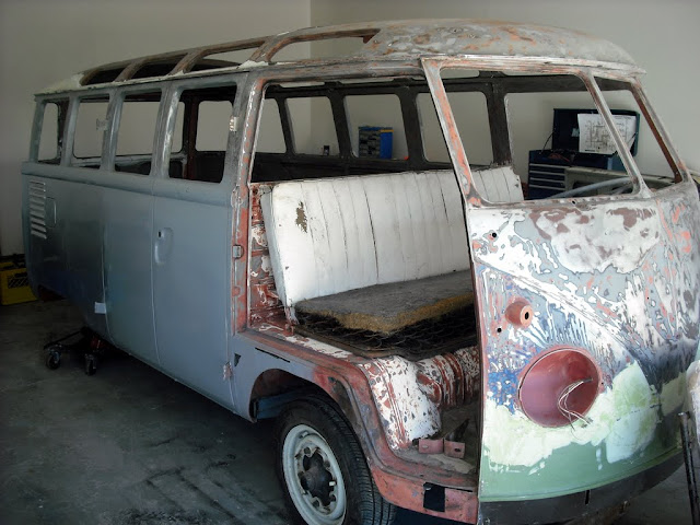

Ok, I think I might have invented this one myself, but I'm sure someone else tried this. I love to spray epoxy. This is miracle wonder stuff. Easy to spray, easy to mix, low voc, dries fast, dries HARD! Amazing. No drawbacks basically.
Then I thought, hey! Why can't I just leave it like that? But it's a little dull. But basecoat is dull! Why not throw clear over it?? And TA DA! I did, and it's sic!
I will get pics but get this. It's basically cutting out basecoat! Your colour choice is very very limited (gray, white, green, black etc), but hot damn, I am in love! Smile
The result? Super cheap, easy to spray (the clear is pretty deadly stuff, but what can ya do), super hard finish. I have no idea how it will hold up or what will happen as the epoxy has on UV protection, but it's just something new I decided to try. By new I mean I have never heard of it here or on AB forums...

dawerks wrote:
OMG.
So you spray the epoxy (BASECOAT) and then you clear over it (CLEARCOAT)? If it's gray,white green etc how are you eliminating it?

So I didn't get really good pics, but if you look at the side of my 23... (Sad thing to experiment on huh??) Smile
Basically at the far back of the bus is the epoxy + clear and some really quick colour sanding. The front half is just the epoxy with no (or overspray) clear.
As you can easily see even in my crappy pic, the rear of the bus has a grey with shiny appearance, and the front has a grey/dull appearance. The 'shine' is in the clear (as we all know), not in the basecoat. So why spend $$$ on basecoat? I don't see the point really.
The drawback is of course limited colours or you have to gamble with tinting epoxies.

PostPosted: Wed May 25, 2011 3:41 pm    Post subject: Reply with quote
cool Very Happy but one problem....will it dye back?...since epoxy primer flashes different than clear and also regualer surfacer primer, it will take the clear with it when it does finish flashing....i wonder if it'll dull?
park it out in the sun as much as possible and let us know about the results. aslo epoxy takes days to flash to dry completely,while clear flashes immediately...curious to see what happens...
you can spray primer,wait for it to flash and spray clear over it too,since it's a urethane system...guys do this with epoxy's and primers in the "rat rod scene and matt clear em....same system, just no glossso if it were to dye back they wouldn't care....so it's not new sort of.

PostPosted: Wed May 25, 2011 4:49 pm    Post subject: Reply with quote
The epoxy was dry for 24-48ish hours and then I was a little bored after spray clear on something else. Then I though, eeeh, why not? I cleaned up the epoxy a bit and sprayed the clear and the result was a real shocker.
I don't think the epoxy has any UV protection, but I have left it outside for weeks/months and nothing has happened to it (on something else).
The bus hardly sees sunshine though Sad Garaged and barely even sees fresh air yet.
Maybe someone in Cali/AZ can do a test panel??

PostPosted: Mon May 30, 2011 5:54 am    Post subject: Reply with quote
34-48 is quite along time the epoxy is definately kicked for sure...
you should try d/a ing the clear and see if it feathers back..if it does then you have good adhesion and the clear bites well to the epoxy.
if it does not feather you are going to have to remove all the clear and recoat your epoxy..but helll you gotta do that anyways as your still the "works"
I think it would look better if you just clearcoated right over the front end without priming it. THAT would look unique.

PostPosted: Wed Jun 01, 2011 10:08 am    Post subject: Reply with quote
I colour sanded with 1000,1500 and it's really tough and on there good, so adhesion is not an issue. The epoxy is urethane chemical comp and so is the clear so they should be friendly to each other Smile
It looked better before the filler (don't worry, it's really thin).
I should clear the roof but I don't think it will stick..

PostPosted: Wed Jun 01, 2011 4:26 pm    Post subject: Reply with quote
I don't think I'm skipping steps, I think I'm taking longer than I should sanding it. It had some horrible white paint on it that was in all the nooks and crannies, just taking the time to get it all off.
I don't have a DA, just hand sanding it (see, wasting time!) Smile
The passenger side was totally stripped, then I put a little epoxy on it just 'to see' and the clear is just an experiment. The only body work that has started is on the nose.
The metal work is done and the bus is already pretty straight, just took a little detour along the way.
I would never just epoxy/clear the 23, and leave it. The side will be resanded, re-epoxy'd, bodyworked', 2K'd. All the stuff is SPI, which is stellar stuff for the price.
