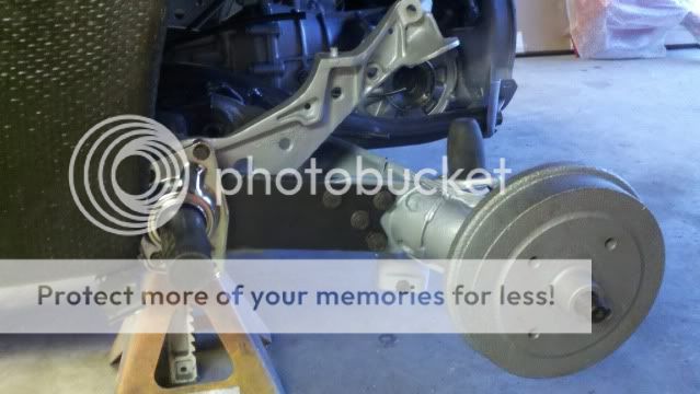

Still rolling along here. I have been trying to keep myself busy with getting the back taken care of. Here is all the parts for one side.
Not much to it. Still need to get to cleaning them all up. Will need new bearings and seals for the back. All bushings for the torsion seem good as well as nose cone support.
Will definitly be getting tranny mounts.

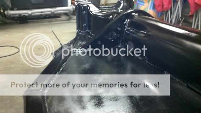

Since the next step is to get it shortened the needed 14 1/2" for the body I went ahead and made the cut. They say it is much better to work on things in pieces right.
I am horrible for doing things in order, but the more paint the better. I was going to wait to put it together until I got a body. Since I wanted to still stay busy I went ahead and cleaned up both sections and primed and painted them.
To deal with the lines running through the tunnel takes a little finess.
There is clutch tube, accelerator tube, (2) emergency brake tubes, fuel line, and (2) heater tubes that will not be used.
The ebrakes get cut off at the rearmost cut and left as it moves them closer to the ebrake handle. The clutch, accelerator and fuel all stay long attached to the front end and massaged back through the rear section and out original holes. Was not too terrible.
Last night I went ahead and squared the chassis up and measured all night long until thoroughly pissed frustrated and wore out. Then I welded it all back together.
Took forever as Iwas getting varying numbers depending on where I measured from and then had to break out 4 ratchet straps and start tweaking it this way and that.
Suprisingly once it was all said and done I was happy with it and feel it is pretty spot on.
I still need to flip it over this evening and weld the underside and that should all be completed. touch up that area with paint and the tunnel is all done.

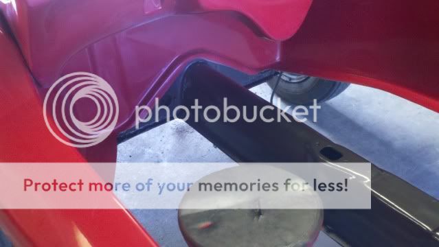

Friday I took off and headed up to New Cumberland to Acme Car Co. to pick up the body. Real big hurddle to get out of the way since without it I would be dead in the water for progress.
Uneventful trip. Cool oldschool place to get anything you need. Engine and tranny work as well.
Got the body home for a test fit.
The front sits on the horsecollar pretty good.

I got a front crossbrace kit that supports the steering column as well as gives a place to mount the stock wiper motor assembly. Seems to really stiffen up the chassis.
Side pods. Really nice touch to finish off the sides. Will have to wait a while for install as they are in the way of everything to keep them attached.
Windshield frame was the biggest bummer of the weekend. It comes assembled. They say in the instructions to bend the ends to match the angle of the hood.
Alright easy enough. Well the passenger side has to be bent so much to get it flush I snapped the damn thing off. :doh:Mad:doh: Pisseed me off. $300 windshield to shit in less than an hour. It was so close too. Just wanted a little more to get it flush. Guys are saying it is the most nerveracking part. I can agree.
Pre break.
After the body was good enough to sit. I got the rear all finished up. control arms in and greased. all hardware in. bearings are good.Brake drums back on and the trans in.
JamisonWorkshop
Joined: June 28, 2011
Posts: 114
Location: Boonsboro, MD
JamisonWorkshop is offline
PostPosted: Mon Jul 18, 2011 1:21 pm    Post subject: Reply with quote
the rear brakes still need rebuilt. Got the CV's apart and just need the boots.
I will have to pull the trans again while I work on a few things but it is just two bolts at this point.

PostPosted: Mon Aug 01, 2011 6:14 am    Post subject: Reply with quote
Weekend update.
Got the floors complete. All welded up painted.
Went with 1/8" floor pan and 2x2 3/16" side rails. Plenty sturdy.
Went with the 2x2 since with the side pods mocked up there was exactly a 2" gap between the body and pod. Figure that is a good area to make up and have a nice strong connection and the bolts going through both.
Once I get my order in I can start on the systems. First up will be pedals, with clutch brakes and throttle. Shifter and linkage as well as getting the tranny in with all mounts and axles. I have everything to make the brakes complete. Steering can start to get finished up to the wheel.
The dirty work is over.
Will pick up some indoor outdoor carpet this week to get the floors covered. May leave tunnel open not sure yet.
