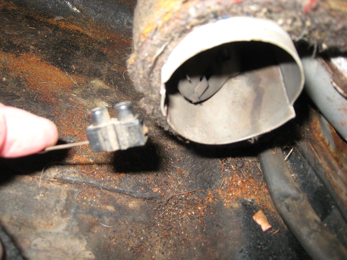

Today I went out and tried to find some things I could do to the car with out having the motor and all in it. I decided to look at the electrical. I wanted to see if all my lights and switches and all worked. I hooked a jumper box to the cables and tried to turn on the lights, nothing! I then realized that the cables are backwards as far as color goes. The red one is hooked to the body of the car and the black on goes to the starter. Hooked it up the right way and still nothing. I got a test light and the only wire that had power was the one that looked like it came from the starter and went into the engine bay. So I am guessing that the motor has to be in and all wires connected to it for all of the electrical to work? I decided to see what would happen if I hooked up the jumper to the other wire in the engine bay. The one that has 2 other wires in with it. I got headlights!! Well, actually I got headlights and tail lights and also found out that the push switch on the turn signal is the high/low beam button! I didn't have anything else though. No turn lights or 4 way flashers. Actually when I pushed the 4 way flasher button back in, a light came on for a split second. I got it to do it one other time, but that was all.
My turn signal switch was loose so I took the steering wheel off, only to discover that the screw was accessible with it on! LOL I wanted to check on the horn wire too though, so it wasn't a total waste! LOL Speaking of horn wire, where is it at? Is it supposed to be visible, or hidden in the switch? I took a pic of my switch, maybe someone can school me on what these copper looking tabs are and if they are the right size and shape. I am guessing that they help make the horn work?
I also found out that my rear heater wires need some help. One just needs to be hooked up but the other is broken off and gone. Is there a way to replace them? For now I don't think I would use them anyway, but I would like to have them be correct, eventually. I can just use my finger to open and close the flaps for now though. For the most part they would be closed to get the air to the defrost and front vents anyway!

Also got the motor all wired and ran the missing wire for the license plate light ran!! Also got the fresh air tubing installed. Hubby had this plastic stuff so I thought I would try it. Never seen this stuff before. Always used that aluminum black stuff before.
I have a newer model oil bath cleaner I will run with for now, till I find the correct one for a 66. I will put it back on once we get the bug running!
With all the wires connected I was able to test my lights. I have running lights, head lights and brake lights. I don't have any blinkers what so ever. Even tried the 4 way flasher. I could get it to make a flash and then it would do nothing.
The PO had one of these clamped under the hood. I forgot to take a pic of that one, but they had 2 more ( ones in the pics) in the glove box. I'm wondering if there might be an issue with these?
They are both blue, even the one in the first pic. It just came out darker do to the camera's angle and lighting.
I have a 66 bug which has been converted to 12 volt. Is this the right flasher unit for this type of a conversion for this year?
