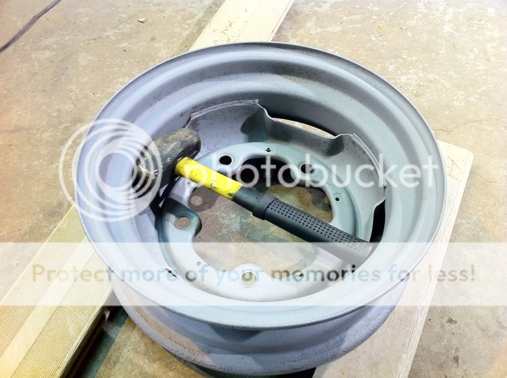

PostPosted: Mon Jul 25, 2011 1:50 pm    Post subject: Reply with quote
The WW rivets and clips worked great. I made my own tool though:
