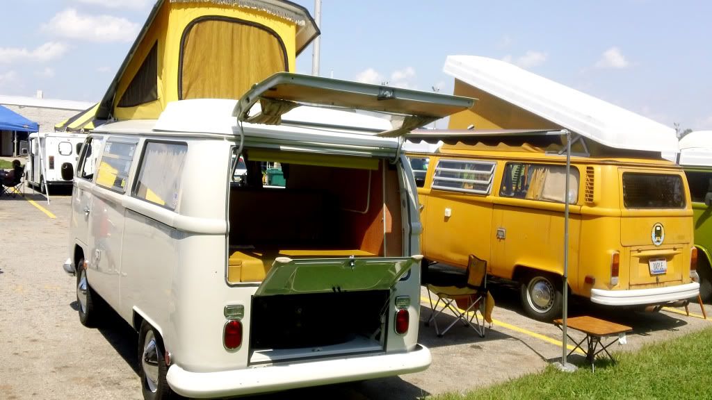

Here's a few buses for the road.
Interior
