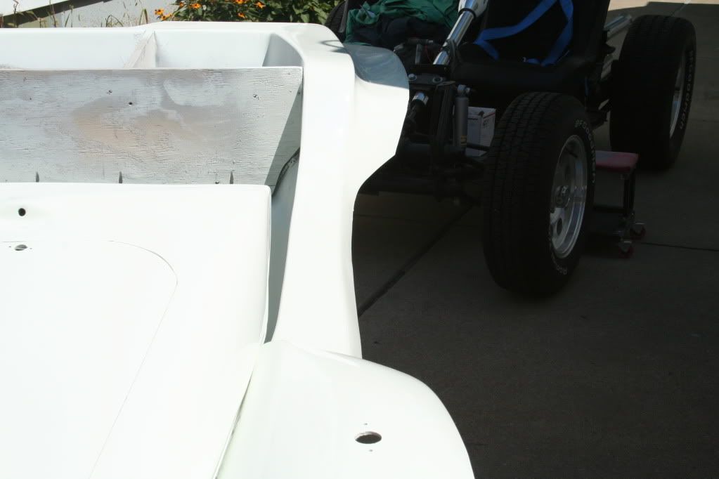

Question - have you reinforced the back of the removable panel so that it won't warp out of shape?

Yes I added several new layers of mat and glass before I even cut out the section. I then reinforced with metal brackets the holes where the head lights go threw. I made sure I removed any wobble or fender that would move with new bracing. The previous owner removed some structure braces on the side for his under body lighting. The guy was an idiot I spent more time re-bracing then I did painting.
So now the headlights bolt threw the fiberglass and a metal bracket attached to the front beam.

What does the underside of the removable hood panel look like? One thing that could be added if additional strength is needed to prevent hood panel warpage is to make an x-brace on underside of hood - you could epoxy either foam or balsawood strips (say 1" wide by 1/4" thick) to underside of panel (I prefer urethane foam and epoxy resin for this; the foam can be bowed to shape easier than wood) - then glass over it to maintain the panel curvature.

I just used two very different fabrics of fiberglass mat and laid them in different directions over a a few days of re-glassing. I did this to make sure when I cut the section out things stayed in the same shape. I made the cut in November and just finished with the body work. I really did nothing for a long time and the price was not having it ready for this season. I had a heated garage but I just got lazy and let it sit.
I understand what your suggesting and I can see it would be much stronger. I figured since the opening was not really all that large the extra stuff I did was enough. I hope lol need to get it on the road and find out. I wished I had painted to pan bolts to match the body but I plan on newer bolts and washers something SS or just paint them black or a white. If my plans come true you never will see them if I get the inside trimmed out with custom made panels with blue and white. The back lid will be made the same striped pattern. My neighbor has a industrial sewing machine and re-done her jet boat. It was very nice. Hope she come threw for me.

Baltek Mat is used to make GRP panels more stiff. I know they used it on the inside of the hood of the Classic Manx. I'm not sure about on the Manxter or Kickout.

Damn sun is bright and the camera just barely can see the pearl
[img]Image may have been reduced in size. Click image to view fullscreen.
[/img]Image may have been reduced in size. Click image to view fullscreen.
Maybe I should use my Canon for a better pic[/img]

Lets see if this looks better.

I'm a little confused (ok maybe just stupid)
where does the water go that drains into the drip shield.
it appears the drip shield is all the way around the opening and
I don't see any kind of drain at the bottom.
what am I not seeing here?

Your missing where it opens at each clip bracket at the very front down low, all water drops on the front end linkage. There is no fuel tank in the front. and the water ran right around and dropped perfectly. I traded this off for another project so no more pics. It was to small for me I am pretty tall so I got a sweet car in trade.
if you go back to the first page you can see in the painted white pics the brackets went past the drain rail so the water just dropped at that point.
