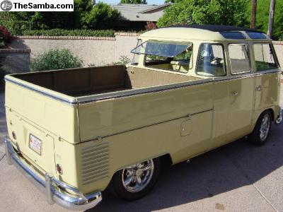

is this one off craigslist in arizona
(o\!/o)
58' pg/sg sub hatch westy
90' doka 1.6td jx import from germany
View user's profile Send private message AIM Address Classifieds Feedback
Grumpy's Metal
Joined: March 14, 2004
Posts: 137
Location: Huntington Beach California
Grumpy's Metal is offline
PostPosted: Sat Aug 27, 2011 2:42 pm    Post subject: Reply with quote
Sub-Hatchtim, I don't know anything about the one in AZ, I have had mine back when it was just the head of a double cab and the body of a single cab, long before it was a single car.
The two parts looked like "Godzilla" had snacked on the two ends.
John

PostPosted: Wed Aug 31, 2011 8:56 am    Post subject: Reply with quote
The one in Arizona is mine. I had listed it for sale but since decided to keep it and now it looks like this.....still lots more to do.
I can't wait to see what you do grumpy. I would love to do the 4th door conversion but no more money
