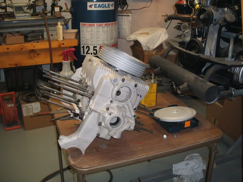

Well heres my first try. It was hell trying to do all this in my 9" lathe had trouble getting everything running true and ended up loosing about a 1/2" on the OD. But not bad for guessing at the measurement. The dia. is off about 3/4" and it looks to deep so if anyone can give me the OD and the thickness of it I`ll make the changes on the next one. Heres the first of the R&D.

Beautiful. Do you know how much it weighs? I'd happily remove my Berg sump and put yours on!

I`d send you this one but need it for measurements. I`m going to make some small changes on the next one that I`m thinking will make it look better shorter tighter longer fins and 9" in dia. As far as the weight 5.7 lbs. a pound lighter then the 36hp Gene Berg sump that I have. Also not sure how to mount it the G B has mounting bolts that look like a 6mm standoff bolt with 8mm holes drilled in the sump so I`m guessing the studs have to be removed. I`ll keep you posted.
And if anyone needs valve covers I have two sets of each that I will unload for a good price.

I like how the Berg sump mounts, EMPI even copied it.
Put me down for another set of VC's. Got a couple more 36's in the works

why not cast the fins?

I could make a split pattern and make a core for the inside I`m just not sure how well the fins would cast with the sand I`m using. They do sell a oil base sand K-bond or Petrobond that give you a much better finish but cost alot more. I may have to try some just to see how good it realy is.

and try to taper the fins so they suck more heat away from the body&oil,also a few fins on the id if it's thick enough will help controal oil slosh.looks great.ever thought about the lost foam method?might make casting the fins a lot easyerand almost a finished product.

I`m not sure I can anwser that one. The old school covers are rounded about as much as the stock covers on the inside so they won`t work. But the racer covers have a much deeper corner that may work without any problem. Splitpile and Mr Motorhead both have the deeper covers and may be able to anwer this one. I don`t make the ones ronnie has anymore ( in the above pic) but the racer cover is pretty much the same cover one more fin and a name. If someone would like to give them a try I`d be happy to work a deal.
Also OOC Mark in Belgium has a set of racers and maybe able to give you an answer.

I just finished setting up a set of Porsche ratio rockers. I'll see how they will clear on the mock up head.

Any word from the salt on how the covers did ?
And the sump looks great !!

Didn't leak a drop! A very nice pair of covers. I used the early style on my bus engine, the custom style on my oval window daily driver.

5 6500rpm passes and dry as a sealed drum
