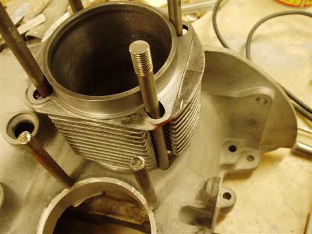

Here's a pic of a 82.5mm cylinder from LN Engineering next to a stock 36HP cylinder.
Keep in mind that Charles doesn't studs for a 36HP case. His VW studs have 10mm threads, and neck down to 8mm. I had to buy 10mm studs from Raceware. Charles says that they'll work, but there will be more stress on the case.
BTW, if you want to read about the different 356 cranks, read Duane Spencer's book (http://www.amazon.com/Porsche-Performance-Guide-Du...amp;sr=1-3).

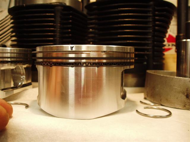

I ran (and just got back from a short run with in town) a 36hp engine with the counter weighted 912 crank cut for 50mm mains out on the salt a couple weeks ago in my bus. Anyone who hears it run agrees that it runs strong . It's cut for 36hp rods at a 72mm stroke with 83mm 40hp big bore pistons and cylinders (lots of hand work as Paul says). I've gone the 74mm route, but your choices on piston sets that are affordable for most folks really diminishes with that larger stroke. At 72mm it's pretty much your choice of rods since the clearance problems are minimal. The counter weights will require some cutting on the piston skirts, they are huge! (bigger than the weld on counter weights) I think it would run well even with stock 77mm pistons especially in a beetle. The costs I think would be within reach for most hobbyists. The most expensive part of running a Porsche crank is finding a set of Porsche rods that won't break the bank by the time they are ready to run.
Crank
Converted 83mm cylinders
Or you can buy some FSR pistons from JE.

Here is the problem area, had to cut just 1 mm on my engine
