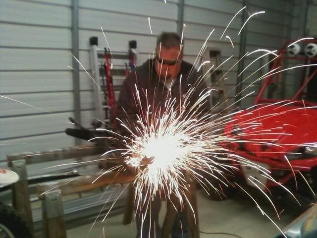

Here's a picture on Mark trying to get the end cap off of the spring plate, the ones on the spring plate tubes covering the splines. Not sure if there is a trick to this or not, but they were a bitch to get out of there. Once they were out, getting the spring plates off was pretty easy. Waiting for a call back from Jer*Fab to order up some lowered spring plates.
