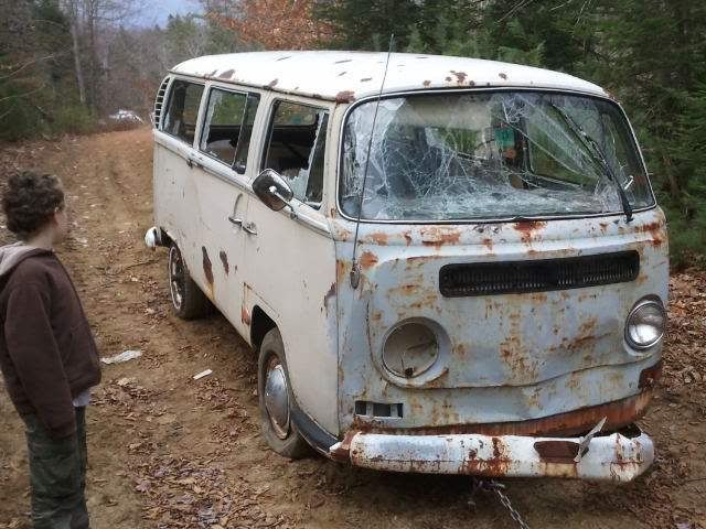

So A few weeks back I posted about "saved two from the crusher"
Well I have decided to save the 69, and use what I can of the 73, and then part the rest..
I'm calling this a resurrection because I only plan to do what is absolutely necessary to get this bus back on the road!
This is the first bus I've ever given a name.. "Good Vibrations" as soon as my son and I pulled out on the road hauling this one home the Beach Boys came on the radeo and well....
So here it is..
Pretty solid down under for a North East bus!

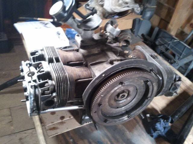

1600 power plant! locked up from sitting..

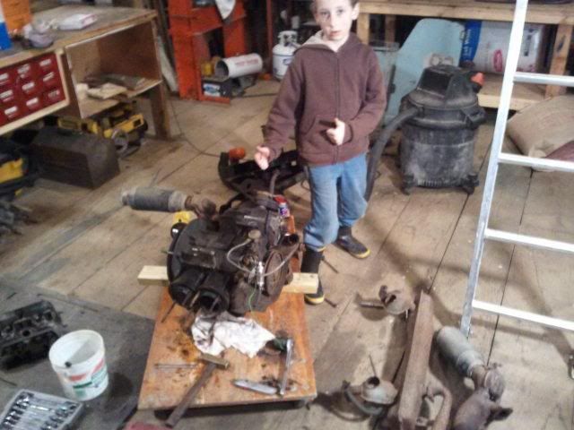

Just after the pull out.... check out the oil cooler... likely get rid of that? Doesn't seem like the best spot
Found cylinder 3 to be what was locked up right near tdc. Penetrating oil and just some slight persuasion and it came free.. Hoping to get her running with gaskets, rings, and a light honing... we'll see. Heads are sure to need some attention too

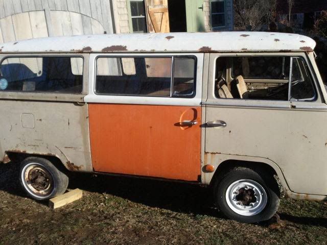

PostPosted: Wed Dec 21, 2011 9:37 pm    Post subject: Reply with quote
Well a little bit to report... Got the other missing side window in, only have the windshield to go and the tarp can come off!
Por 15! then primer where needed..
Made some progress on the engine too...Cleaned everything, painted the tin, new rings, honed cylinders, new exhaust valves and cleaned up the intake valves, new push rod tubes, gaskets.. looking forward to getting it dressed now.
