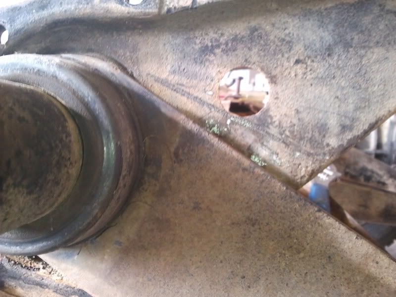

'74 Sedan pan. I also put this post in my build thread and thought it may do some good over here in the off-road forum. Sorry if I'm breaking the rules (Mods do what you must).
Here are a couple of pics from me reindexing the rear end. 8MM serrated end wrench for the cv bolts.
The first pic shows the most the trailing arm will droop. Disconnecting the break line gave me enough clearance to get the springplate off of the stop. (I did end up removing the trailing arm to get the springplate back into position.)
After getting the spingplate off of the stop, I scribed a line to show the stock position.
Here's the difference after going down one outer spline. (before compressing and putting it back on the plate stop.)

Hibbard says to line up the bottom of the springplate with the bottom of the lower bolt hole for max lift on an IRS car.
did you check for that?

That's how I did mine, mainly because I forgot to scribe a line at the stock location when I pulled the first bar. It worked out ok, though. A lot of clunk at first but it settled in nicely.
The whole thing was surprisingly easy. I should have done it years ago.

No I did not! I just went one outer notch... I'll check it when i do the other side Rolling Eyes . It should go faster than this one. I'll try to take more pics.

Reindexed the passenger side last night... One outer notch down lowered the springplate to cover the top 1/3 of the bottom rear torsion bar cover bolt hole. make sense?

I don't have a copy with me, but my ancient memory says that Hibbard said:
cover 1/2 of that hole for max reasonable lift on a swingarm
cover all of that hole for max lift on an IRS
making me think that 1 inner spline would cover the hole. of course, there is no rule that you have to go for the max lift or do what Hibbard says
