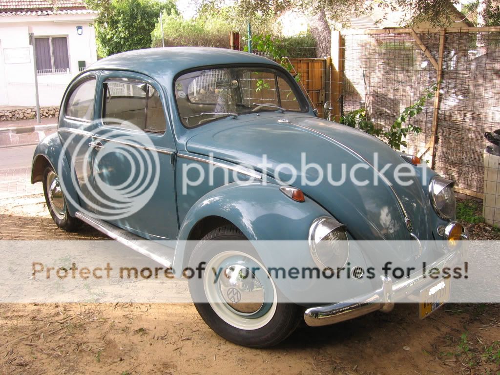

well, it's been a few weeks. Just want to post the progress on the wheels with pics:
After a car was and polishing the chrome:
Wheels ready to sand blast
sand blast media
sand blasted the paint off, not sure if it was original but is was old for sure
Powder coated tiger 9016
tires back on, now comes the hard part
Since powder coat is so thick, the grove valley between to two metals is gone. Taping was more than difficult and required a lot of patience and finesse.
It was cold and late so I decided to paint inside lol
took the glove box door to get colored matched and came out an exact match!
don't know why it looked green in person and in the picture
took my time with the tape job and it still didn't come out perfect
I was prepared for that and with a tinny art brush i finished off the outline
Wheels back on. The chrome polish wasn't enough for 2 caps so I got them re-chromed. They went a little heavy on it and the VW almost vanished.
Before
After. this side has the new chromed caps
This side the caps were just polished
EDIT: newer photos

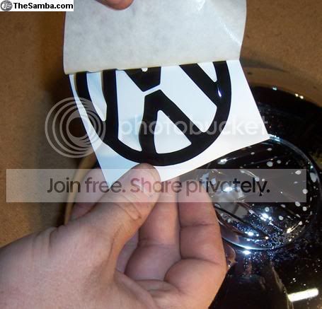

Here are mine. Sand blasted with tires off. Replaced broken hubcap clips. Using automotive paint, primered all over. Then painted satin black inside and behind, and cream white and Gulf Blue L390 (in that order) on front. Got new hubcaps. To finish it off I added year correct black hubcap logo stickers (bought here in the classifieds).
Before:
During:
After painting:
Logos:
After:

Looking good beetleman! where did you get that logo?? I was about to free hand paint.

PostPosted: Sun Feb 26, 2012 3:25 am    Post subject: Reply with quote
http://www.thesamba.com/vw/classifieds/detail.php?id=858763
Much easier, quicker, and cleaner than hand painting.
