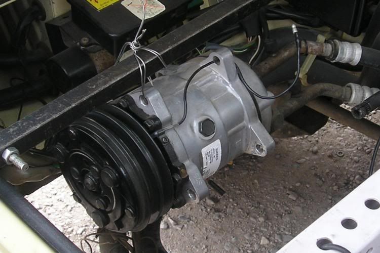

I have a small leak emanating from my T-Stat housing as well, and fear I may need to pull this soon. My big concern is that I have AC, and the compressor is directly above the housing. I'm nervous about removing the unit and bungling the pipes with the refrigerant. Do you have AC? If so, how did you go about this issue. I'm guessing you don't, but here's hoping. Anybody else out there have any advice?

Ahwahnee
Joined: June 05, 2010
Posts: 3062
Location: Mt Lemmon, AZ
Ahwahnee is offline
PostPosted: Sun Feb 26, 2012 9:58 pm    Post subject: Reply with quote
BetaVan wrote:
...My big concern is that I have AC, and the compressor is directly above the housing. I'm nervous about removing the unit and bungling the pipes with the refrigerant...
Couldn't you undo the compressor and lift it out of the way w/o any disturbance to the hoses?
