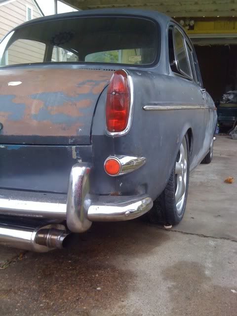

Ya those are porsche turbo twists, they come in 7" and 9" variety, you'll want all 4 7's like flyinglow said. Their ET is 55. I just fitted a set yesterday, with IRS you just need to clearance the bump stop on the subframe a little and machine down the stub axles a little (portable belt sander works great for that) so the center caps fit. I am SA and get a little rubbing on the drivers side inner fender, IRS won't have that problem.

PostPosted: Wed Jan 11, 2012 9:57 pm    Post subject: Reply with quote
The next time I pull a rear wheel I'll snap a pic but it's pretty obvious when you bolt them on. The PO lowered it so I'm not exactly sure how many clicks he went down. My front left tire rubs on something when I hit a big bump, I'm still trying to figure out where exactly. The fronts do rub a little on the control arms at full lock.

Sharkskinman,
Do you have a picture of your wheels?? I found some great Porsche wheels that I may go pick up on Monday, unless I like yours better. Will 7.5" wide fit all the way around without modification??
supaninja
Joined: July 03, 2010
Posts: 3971
Location: houston
supaninja is offline
PostPosted: Sat Jan 21, 2012 9:59 pm    Post subject: Reply with quote
Ya Sharky, what offset are they?
