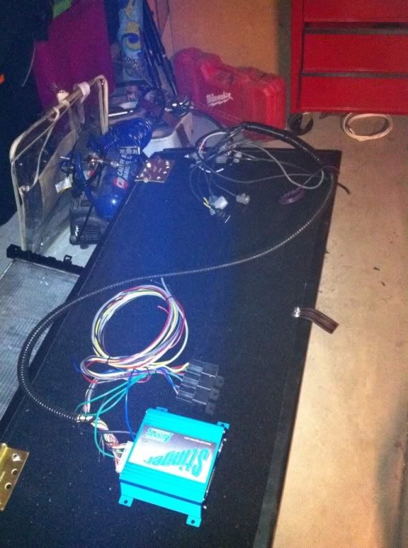

The brains o the operation.

Dale M. wrote:
HE is also running Megasquirt for ECU as it was a whole lot simpler to build new harness and wire in the MS then revamp stock harness and try to get ECU reflashed to proper ratios... With MS all you need is laptop and "tuner software"...
Dale
... no 'ECU reflash issues' with using stock Subaru ECM. None. Nada. Zilch. Zippo.
What ratios are you referring to? Tire diameter & VSS?? The VSS can be defeated - www.enginewiring.com
http://enginewiring.com/catalog.htm > Subaru Vehicle Speed Sensor Simulator - "This simulator can be used to eliminate the need for a mechanical V.S.S on most Subaru engines when using a VW style transaxle. Eliminates the malfunction code issued by the ECM by providing it a proper looking V.S.S signal.
No moving parts to fail or fly off like the old "magnets and a reed switch system".
Wire it in and tuck it inside the split loom of the harness and your done once and for all."
Subaru - Factory Harness Modification:
All Series Through 2002 $495.00
Price includes process of secondary harness that incorporates the alternator on some models.
These second harnesses will be returned much smaller.
V.S.S. Simulator included and installed with this conversion.
Again - how many have used the Stinger/MS/Haltech/etc.... straight outta the box? What does chassis dyno tuning time cost?
bnc
Internet listed credentials impress no one but Mom...
streetbuggy8804
Joined: August 25, 2009
Posts: 525
Location: Long Beach, Ca
streetbuggy8804 is offline
PostPosted: Mon Jan 16, 2012 8:48 pm    Post subject: Reply with quote
According to outfronts and all the research that I have done, the stinger comes tuned out of the box. Only tuning necessary is if you wanna adjust something.
