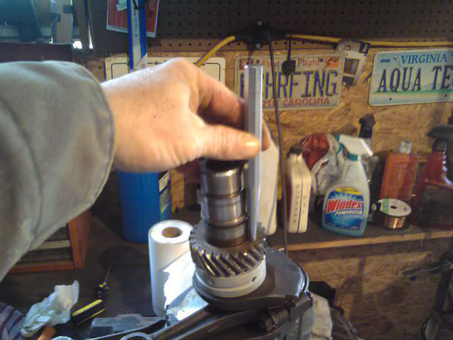

Next we need to get our new bearing on the crankshaft. Most people take it to a shop and have the gears pressed off. With my budget we're doing it ourselves. First remove the lock ring:
A gear puller will barely get ahold of the gear, so to keep from damaging the edges of the teeth heat it with a propane/soldering torch for a minute to help expand the gear and relive some of the interference fit:
Now put on your bearing and replace the gears with the use of heat and a punch used carefully working your way around the gear to ensure it is going on straight:
I like that book you are using, plenty of pics ... About the cheap aspect
maybe you skipped the detail about evaluating the case measuring align boring and determining thrust cut as well as internal and external dimensions on bearings, this cannot be fudged ...
Here's a money saving idea thats even cheaper than that gear puller -> when removing gears from the crank place it in a bench vise in horzontal position then use a large dull punch on the #3 main to walk the gears off the shaft. You will be using a large hammer and you will ruin the used bearing but your hammer never touchs the crank, bearing material is soft ... Also makes for excellent arobic excersize....Also if you have removed the cyl head case studs you can use a large phone book in lieu of an engine stand, tilt the left half and prop at 45 deg angle.. This is true poor boy engineering and it works. Good Luck and keep this project going. Very Happy
Very Happy
Here's an even cheaper way to install the gears. As per the Bentley, heat the gears in oil to around 180º F. A laser thermometer is super handy here and tuna tin is just the right size. Pull the gear out of the oil at times and check it's temp with the Laser thermo. When it's hot enough it will just slide on the crank like butter on a hot biscuit. No pounding, but you gotta be quick cuz as soon as it hits the crank it starts to shrink.
