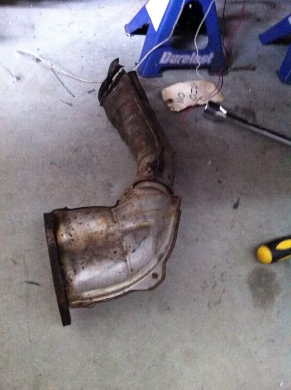

Got some goodies.
Rear facing Thermostat housing.
Got these Fromm the junk yard. They were already cut off where the cat or merged part would be. Works well for my needs. To to chop and re weld.
