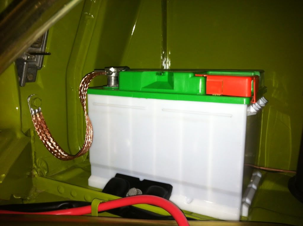

PostPosted: Mon Feb 20, 2012 6:23 pm    Post subject: Reply with quote
I also went and got my battery, its a Interstate MT-47. The fit is tight and will have to grind just a little off the battery hold down off to make it perfect. You will notice battery is not hooked up as there no engine or tranny in yet.

PostPosted: Wed Feb 29, 2012 5:16 pm    Post subject: Reply with quote
more pictures of the progress
