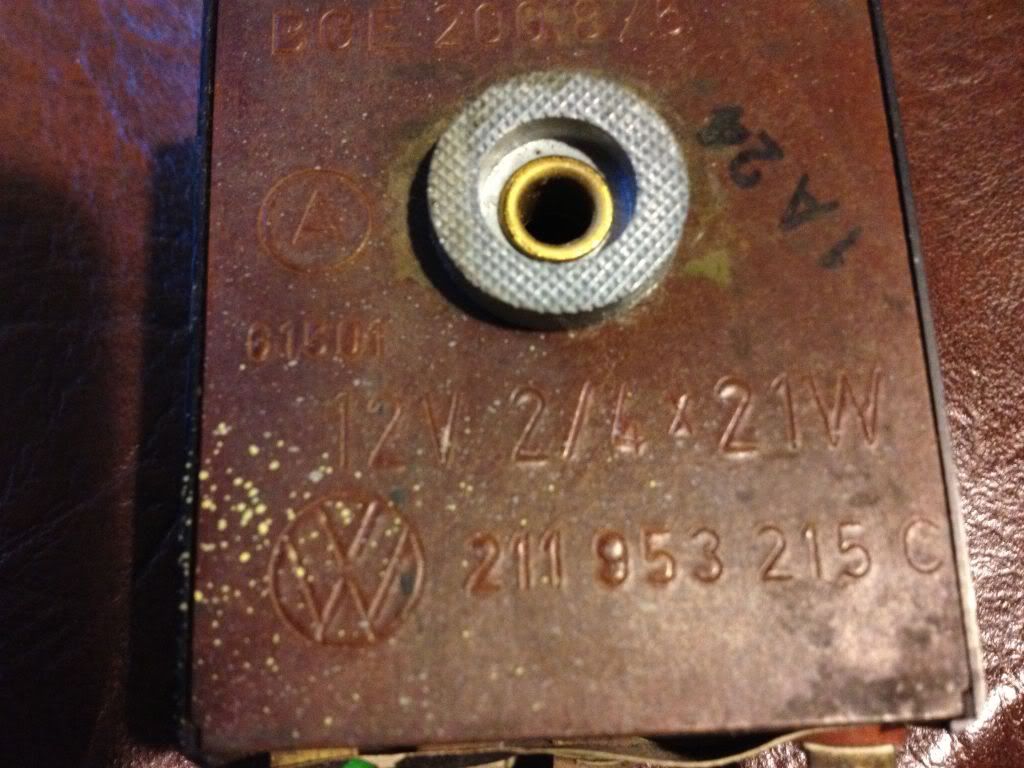

PostPosted: Thu Mar 01, 2012 3:28 am    Post subject: I fixed the flashers Reply with quote
Back in January I grabbed a bunch of stuff out of a 1973 Ghia going to the crusher at the scrap yard. I've had an unreliable in my 1970 Ghia. I was looking at the relay with 49, 49a, and 31 from the 1973 Ghia and it had the same #'s as my 1970 relay. But there was a difference, my 1970 relay had a 4th lead marked "KBL", whereas the 1973 relay only had 3 leads and no "KBL" lead. I hooked up the 1973 relay to the 1970 wires and the flashers worked great but there was no "arrow" flash on the dashboard. I just added the "arrow" flash "blue" wire to the 49a lead and the dashboard arrow worked, too. Problem solved!
Old relay (attached to wires) and 1973 relay in black
Old lead #'s 49, 49a ,31, and KBL
Old lead # 211 953 215 C
