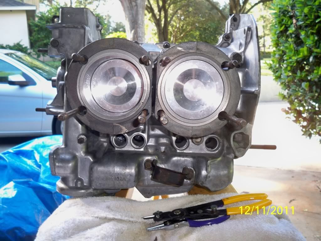

Just bring him the cylinder that's what I did. these are the 1.8 P@C from the ebay guy they are AA pistons

In the AA listings the 1.8l sets are the same but they look dished. How much dished I wonder so I would email em. The 914 pistons were slightly dished for a 7.3 to one CR for 72hp. What is the engine code on the case?
Type 4 gaskets sets fit the 914. The only difference is between the 1.7/1.8 and the 2.0L sets with different cylinder gaskets.

Didn't 914 engines come with dome top pistons at least that is what i pulled off mine anyways Confused

W and EA code 914 1.7L engines came with domed pistons for a 8.2 to 1 CR and 80hp. EB were low CR flat topped bus pistons for a 7.3 to 1 CR and 73hp.
