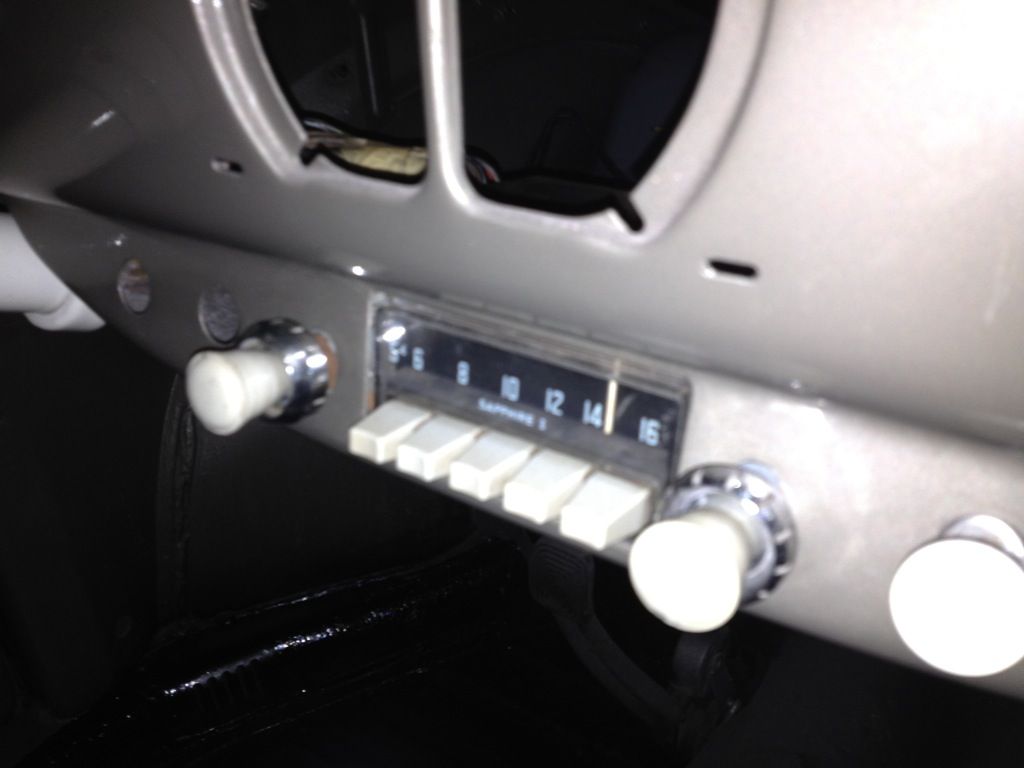

you need the vertical push button sapphire I, not the sapphire I you have pictured to fit the hold correctly.
Greatly appreciate that information. I was unaware of the distinction in Sapphire I radio's. Shows you learn something new everyday. I'm glad I asked and didn't "hack" fit it. I'll put a vertical one on my wishlist and get this one to someone who can use it. Oval window folks are great with sharing the info! Many thanks!
