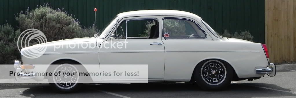

the car in the videos is a 69, same as a 70 and up running gear (irs rear end)
just go for it you will find its a dream

dragsters, nice car and rims, how much lower is the front from the back. what size tires and rims are you running
got her lower to the ground in the rear today
the wheels are 5.5x15 with a 42 offset
rear is down 2 outers, rolled the guards and running nankang 165s
the front is also two down but may go another as its lower in the rear now
running nankang 135s
no rubbing at all cut down front bump stops and think the rears need to go
