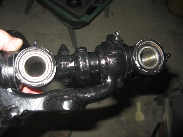

Used a ball remove/replace tool for American iron to push out the link pin sleeves on my spindles. Had to make a little push tool for the sleeves.
The tool I made for pushing out/in the old/new sleeves.
Finished process. Easy Peesy!

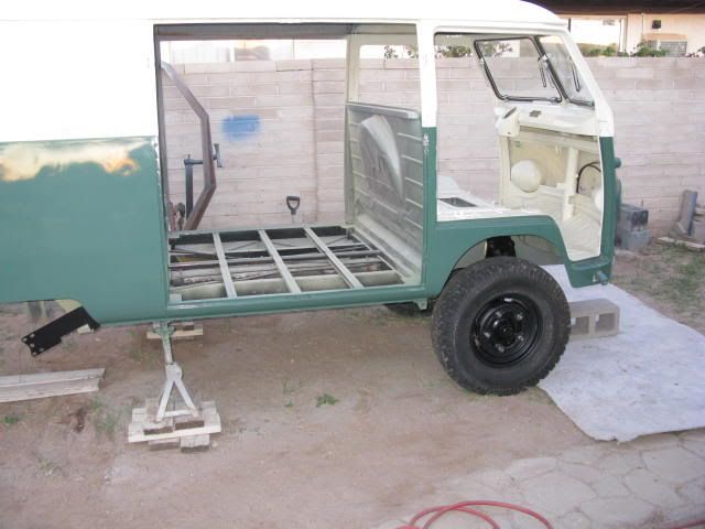

Got the rear suspension done today. Had to relocate the shck mounts. Then I put it on four wheels. Getting closer.

this is going to look wild coming down the road. you sure are making short work of getting it together.
