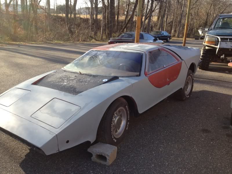

My son and I have been searching for a project to work on, he is 10. I felt it would be a good way for him to learn about various mechanical systems. He is however somewhat of a Top Gear fan and immediately started looking for anything high end Europen. I was thinking more like late 60's muscle car, so I thought I could sway him to a mid 70's Porsche 944. He wasn't impressed, so he set about looking on ebay. He came across a FiberFab Aztec 7 "complete kit car" that was very reasonable and after reading some more about the history of this model it sounded pretty good. Very basic mechanical system and a futuristic looking body. So we are now the proud owners of as we call it "vintage" kit car. Our plans are to strip it down to it's chasis and restore it from the ground up trying to keep it original to it's roots as a VW base kit car.
I hope to garner some knowledge on this site, I already have over the last week or so and keep a running thread on our progress. We hope to finish it and show it at Carlisle's Kit Car show one day. So here are a couple of pictures of when we went down to pick it up. Wish us luck!!!

Did you get the "flux capacitor" with it....OOPS wrong car....
Looks like great place to start with a junior gear head....

I just sold mine.
I didn't get a real chance to dig into it but I wish I had. I like the styling.
What I did notice was that the doors were a little flimsy as was the rear hatch. I would definitely add in a steel subframe to help them out.
Obviosly be very careful of the windshield...its worth its weight in gold.
I would also consider relocating the shifter and ebrake.

Nice find, and pretty complete as well ! !
Considering that the windshields are rumored to come from the Lamborgini Muira and cost $2,000/$3,000 each, you're very lucky.
With the design based on the Bertone concept car:
http://www.carbodydesign.com/archive/2009/07/02-bertone-alfa-romeo-carabo-concept/
Your son ought to be very happy. His dreams of running a Top Gear style ride are assured. Even keeping a VW engine in place, you can build it up to a nice horsepower number., and suspension upgrades are an email order away.
Looks like you both are in for a wonderful time ! !

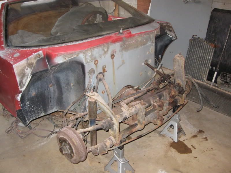

Got the body stripped off today, now it has been reduced to a rusty VW. Pans are totally gone and the are a couple of rust spots on the tunnel. Right now I am thinking of building a frame like you guys with the buggies do and put in diamond plate floor panels
Sorry for my ignorance, this is my first VW anything, even though I do sorta know my way around a car. I have done a lot of searches on front beams and have seen many photos of such, but I have not seen a set up like this. Anyone know what this is?

That is a "select-a-drop" (I think thats what they called it) in your front beam. Its the old school way of adjusting the front ride height. Nothing wrong with it. Lube that center threaded rod and adjust to your hearts desire.
While you have it apart I think you should drop the pans and relocate the shifter and ebrake. I know the original console is designed for the shifter in its stock location its really not an ideal driving position.
Relocate it back by about 8" and use the dash space for a radio or gauges.

Yup, old style select-a-drop. Soak everything in rust-buster just to get the nuts moving on those threads! Jeff has a good suggestion on moving the shifter back as well as dropping the pans. Both well covered in other threads here.
