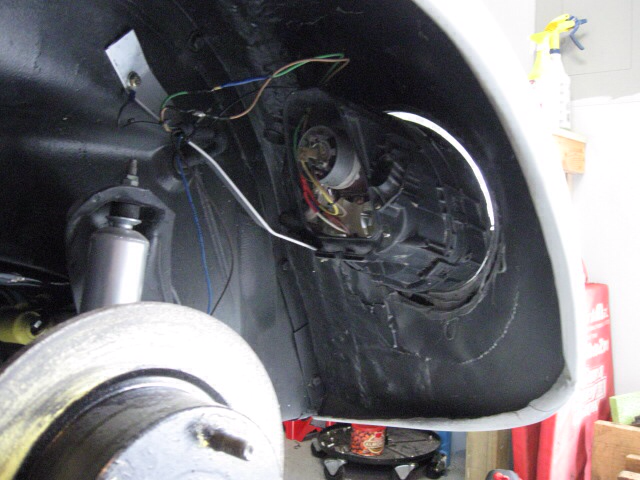

Thanks Derrick for your pics. I can see from my initial messing around I will probably have to extend the fenders as you did in order to gain about 3 inches more clearance for the headlights from the Mini. You did a great job!
Here is the mini housing which is about 7 inches deep versus the stock headlight bucket at about 4 1/2
The Left Housing
Another measure
Sizing the Mod by eye only. Looks like I need Derrick's mod the clear the tires. The lines are 4 1/2 depth and 7 inch depth.
Image may have been reduced in size. Click image to view fullscreen.Image may have been reduced in size. Click image to view fullscreen.
I am going to start looking for some usable super front fenders that I can cut to extend the lights forward as Derrick did. Here's his mod.
I really like the way this resembles the early Porsche lights.

I have decided to back off on this part of my project so maybe I will have the car 's stock bodywork done and painted by next summer. I have extra front fenders which I can modify but I think I want to see how much clearance I will need to the back of the headlight housings once I have the topline struts and mag wheels on the car. I can cut the extra fenders off the body and do all the metal work as well as making fiberglass buckets to encase the headlight rears. They are not made to be in the splash zone from the tires and will require a bucket over them.

The Mini hood is a 2 ply construction as you can see from the one inside shot. That all has to be cut out except the three mounting holes. I will then have to contour the top to mate with the existing fender and cut away the existing bucket and surrounding. Then I will beat a panel(s) to fill in below. I was also looking tho extend to lower area which curves under the light downward to make it look more like one piece fronts used on drag cars.
This should meld in nicely with the spoiler I will make for the front and will look more like a pre A Porsche. I should be able to use the back (where the running board bolts) of the spare fenders I have to do this
