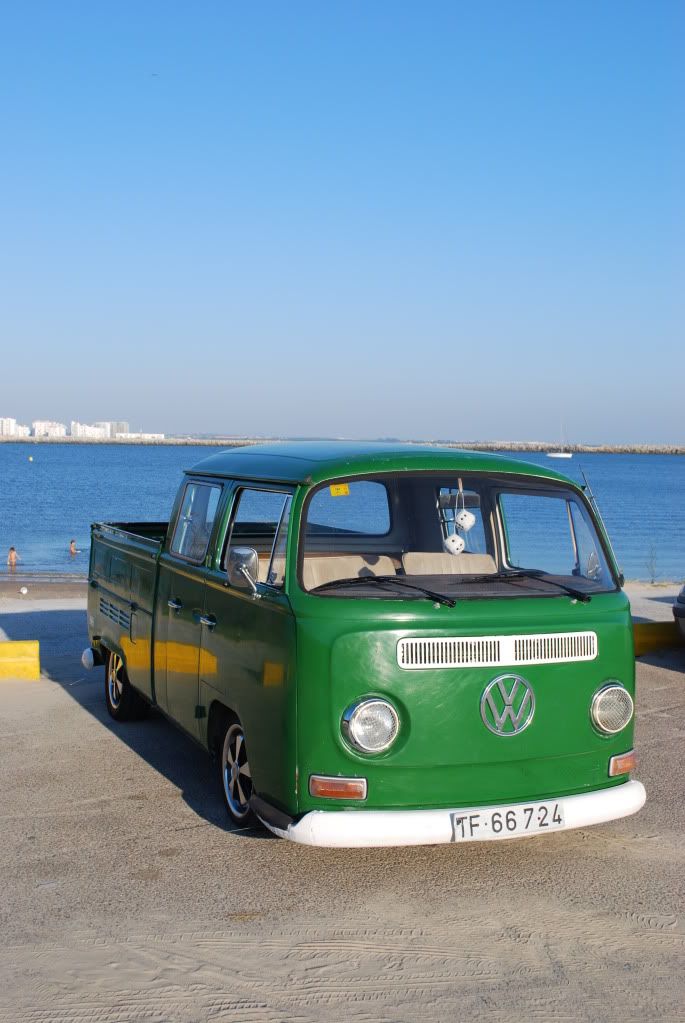

fastwagens wrote:
anyone running federal fermozas 165/50-15 or 165/45-15? If you are could you please post a picture for reference. I have some 6" cookie cutters on the way and starting to look for what i will roll.
thanks
I'm running federals, 185/55 in the back and 165/45 in the front. I have hit a pot hole w/ the right front one and caused it to leak slow but no damage to the wheel. It was repaired. High end sight 20/20, I would have gone with 165/50s. That's my suggestion.
