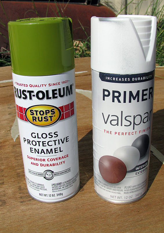

Yeah, I was thinking about it this weekend, it's been repainted, and has its issues, and DEFINITELY needs a whole nose. I'm really thinking about trying to wax the paint to bring it back some, maybe getting some paint to match to put on the nose for now, so it looks decent while we're fixing it up.
I don't mean to highjack your thread, but I found this paint @ Home Depot a few days ago:
With your bus having been repainted, I can't say how well it will match the respray color, but it matches my OG paint almost perfectly. It dries to a satin finish so the tint looked a little off, but after I put clear over it to add gloss, it was virtually a nuts on match. It may be worth trying on your nose. The color is called "eden". Nice build BTW.
Rustoleum also makes a gloss, standard rustoleum called Fern something. Its nearly a spot on match for Sage Green as well. Saw it at Lowes Home Improvement.
