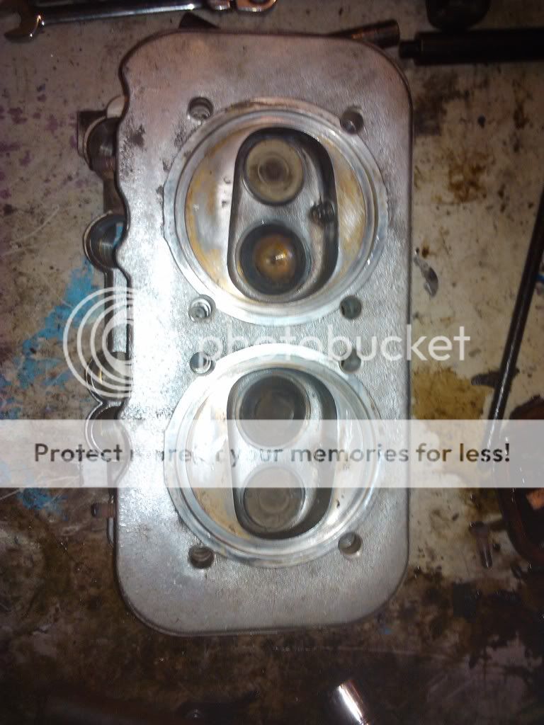

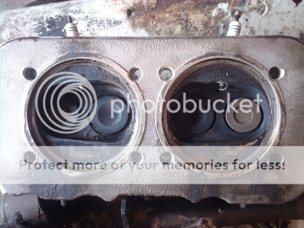

well today we took the heads apart checked the cylenders and rings everything checks out good so im wondering if the mechanic adjusted the valves to far in and they were holding the valves open heres a pic of the head all cleaned up and back together

None of those look really lean and only the lower RH exhaust valve looks sorta normal, did your mechanic do a leakdown test to determine where the compression was going?
