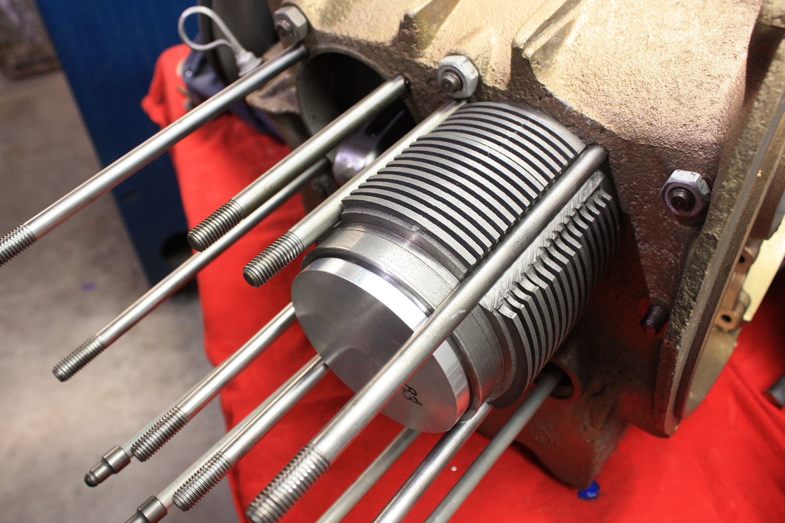

Yikes! I could see running those on a drag strip or short bursts but on a road trip to So Cal i'd be a little more than worried about heat distortion and possible cracking of the cylinders.
Looks like they were just spun on a lathe and took off way more than needed. I've seen a few sets done by hand (profiled fins and only removed the needed areas) and yes it's a lot of work but a lot less than rebuilding a perf 36hp engine on the side of the I-5!
I sure hope this works out well Kenny but maybe think about changing those up.

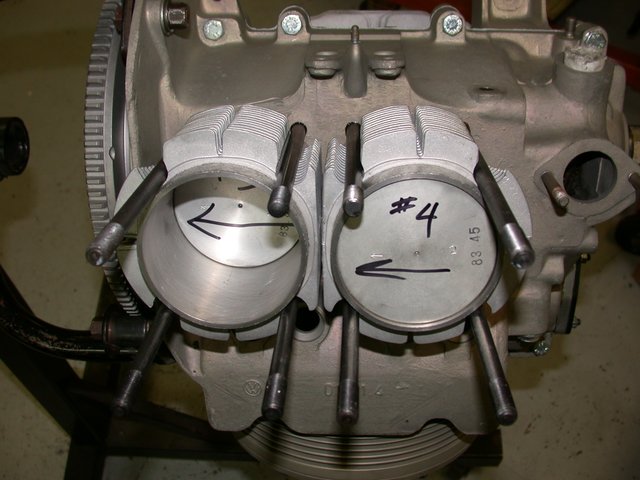

a set of Birals would be nice! pic from Mr Okrassa

Concept1 wrote:
RPGreg2600 wrote:
Those cylinders don't have much fin left. Not too worried about overheating?
I am worried.
Rimco turned the barrels down for me, as I had heard they have clearance issues not only between them, but also for the cylinder tins to fit. It seems to me like they took a fair amount off.
In the meantime... Motor building has come to a complete halt while I'm waiting for JE to make a set of custom poisons for me. I had a little bit of poke, out the top of the Cylinder...
Ken I would try and get some 83MM Porsche 356 cylinders from A A (the fin depth is 11.75 MM). I have 82.5 Porsche 356 and they fit fine with real fins in my 36hp. We just machined the spigots down a little and bore the heads and case out to fit.
You also need to work over the WW Okrassa heads. I gained 8hp by decking and porting the heads. My 1192 36 made 64hp on a flywheel dyno and it's my daily driver with no issues. You should make a LOT more HP with the bore and stroke you're running.

I am worried.
I'm running mine with maybe a little more fin, no over heating problems,actually quite the reverse. It was a question raised on this thread:
http://www.thesamba.com/vw/forum/viewtopic.php?t=499975
Looks like the barrel got the fins just turned off on a lathe........Rimco has a tendency to cut too much off. Maybe knife edge the fins to pull the heat off faster. It's some time burning hand work but I think the result is worth it.

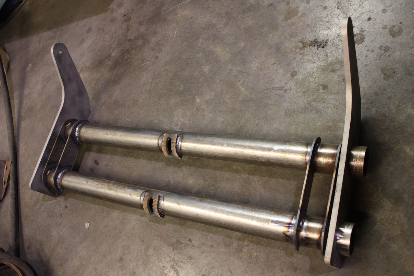

Front beam- I decided to go with a 2" narrowed beam, build from scratch.
I built a quick jig to hold everything straight while welding it.

Beam looks great! That's some fine craftmanship there. Cool
Nice job, what kit are you using to do the welds? Cool
X2 Hell yeah..Nice man Cool

Thanks! I'm using a Miller Synchrowave 180 TIG welder. I took a night course at a local technical college about 6 years ago. I have a certificate from them as well. I think it states that I am fully qualified to weld decorative fence gates Laughing
