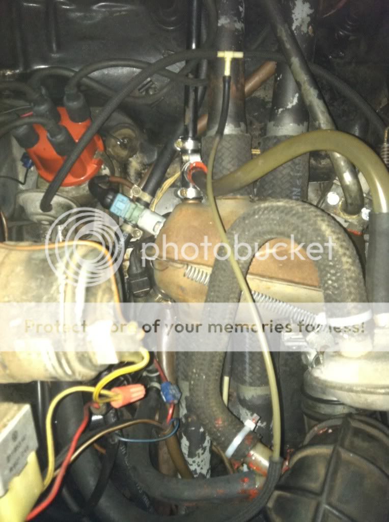

SixStringMadMan
Joined: December 02, 2011
Posts: 98
Location: Roseville, CA
SixStringMadMan is offline
PostPosted: Fri Mar 30, 2012 7:39 am    Post subject: Reply with quote
Let's say the hoses that come off the Sboot to the engine, and the hoses from the round silver metal device(that is attached to the middle of the upper firewall) to the Sboot, can't remember. Does that make sense?
I'll attach another members engine picture as it has the hoses in question in plain view. This is from the Father Son resto thread
1978 Kombi
http://www.vw-mplate.com/mplate-10020.htm
busdaddy
Joined: February 12, 2004
Posts: 24136
Location: Surrey B.C. Canada, Land of the giant flying moose!
busdaddy is offline
PostPosted: Fri Mar 30, 2012 7:49 am    Post subject: Reply with quote
Hmmm.... must have been some sort of glue or sealer. Not necessary if the hoses are in good shape and could damage the AFM in the event of a backfire.

SixStringMadMan
Posts: 98
PostPosted: Fri Mar 30, 2012 8:41 am    Post subject: Reply with quote
Thanks BD. Just found a shot of my engine on my iPhone. Looks like the two connections on the Sboot have the red goo as well as the clear pipe going from the metal doughnut to the top of the engine. The clear pipe, even with red good and a clamp, just slipped right out.
1978 Kombi
busdaddy
Posts: 24136
busdaddy is offline
PostPosted: Fri Mar 30, 2012 9:22 am    Post subject: Reply with quote
PO shenanigans, looks like red silicone RTV gasket maker, good hoses need no sealant or clamps and should be able to pop off in a backfire.

RatCamper
Joined: November 13, 2008
Posts: 3307
Location: Australia
RatCamper is offline
PostPosted: Fri Mar 30, 2012 2:21 pm    Post subject: Reply with quote
busdaddy speaks truth. Also may I add that red goo like the red permatex gasket stuff i don't trust at all. Having it dissolve is one thing, but when it's can get sucked into an engine, and contains silica I'm a bit wary of it.
