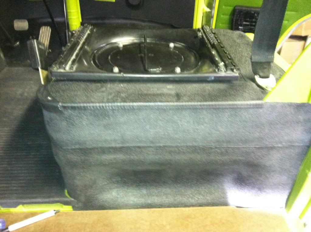

curtis4085 wrote:
Well I finally finished my seat stand mats. The piecing the swivel seat together was pretty easy to do. Just make sure to take your time in measuring to everthing looks nice and tight. THe big factor in the whole project is the having to buy extra set of side mats and top seat stand mat to make it all look good.
Here the finished product
These look really nice. I'm wondering what you used for the coping on the top? I do have the corner pieces you screw down but am missing any coping/molding to hide the metal edge where the horizontal and vertical edges meet. Is that part of the kit you ordered?

BayJay wrote:
send copy of the above picture to CHris at bustedbus.com and tell him i reffered you. He has them. I had to trim mine a bit to fit but it is the fix needed for this application. THat piece of molding is of and earlier model bus by the way. On these swivel seats the OG mat used to cover that lip. Hope this helps.

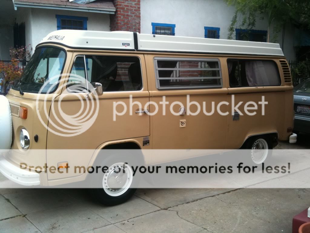

perfect. Thanks. I saw that you got it from Chris but didn't know the part number etc. I'll get a hold of him.
I've got the 1979 in Mexico Beige P27 model. I love the color and restoration work on yours. I've been following the thread with great interest. Mine is all stock except for some missing parts here and there and although I won't do a full resto like you did, I'm picking and choosing my favorite things. Yours is an inspiration for sure.

So they had that piece and you didnt haveto trim one?
You have super nice bus there. Sorry I do not have part number for that trim piece.
Notch boy the trim molding did need an inch or two cut off the end to accommodate the corner molding as see in picture. I think if anyone has to do the seat stand mat fix having the corner piece allows for better overal look in the end.

OG trim piece for my 1978 Westy;
1978 Sage Green Westfalia
Nice.
FYI - It's much easier to cut top patch if you have the larger corner trim piece to cover your cut edges. It hides much better from what I found.

Curtis, Did you put the top piece ( the one you "manufactured") on the passenger pedestal under the lower piece ...did you "overlap"....or... cut it so that it lined up perfectly with the upper seam....I am very impressed with your craftmanship...and should be doing this next weekend...thanks, Bob

Ashley1. I'm guessing you are talking about my side pedistal patch. For that one I place lower section on first as this requires no cuts. Let dry. You will notice the top rear edge fits into the contour of the bus pedistal. Them for the patch you will use the driver side pedistal mat you bought extra. Has to be driver side to do it right. I turned the mat up side down and used the factory edge to over lap the lower mat. It fits nice as the lower mat is sunken in the contour of the body. I used soft clamps to hold mat in place as I trimmed piece to fit. I trimmed slowly and gave much thought to the cuts. If you want I can pm you my number and can walk you threw it.
