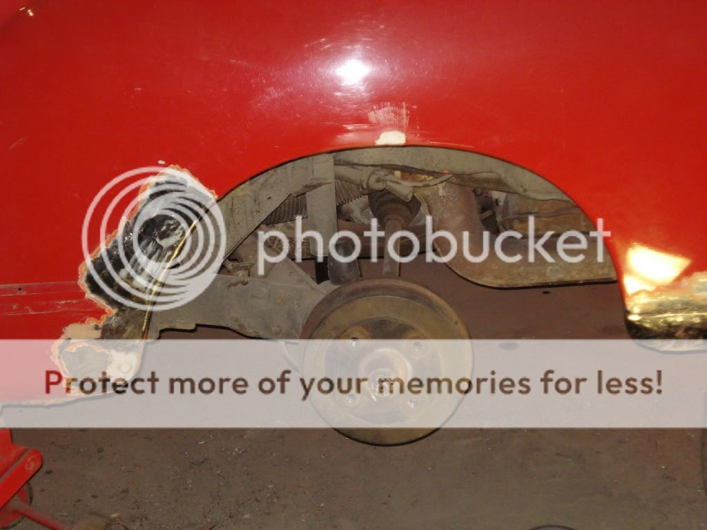

needs some welding
and allso some welding around the back wheels (i will post em asap)

what i did today
i cut out some crusty parts in the back and did some welding (im new in the welding and stuff, Wink just saying)
i will allso renew the inner crusty plate.
made some parts
welding (not high quality welding)
this is from the previous owner, i looked for a "new" piece but cant get that part annymore, i think remove the whole "welded part" will be a whole lot of work. guessing to leave it how it is and renew it in the future.

PostPosted: Fri Apr 06, 2012 8:48 pm    Post subject: Reply with quote
No apologies needed for the welding. You look to have good penetration which should make a very strong joint.

PostPosted: Sat Apr 07, 2012 9:30 pm    Post subject: Reply with quote
Looks good, Just a note on the welding. It looks like you have not welded the seams completely. You got the right idea to tack them to keep heat down but you should jump around and make sure you have all of the seam welded. Some times even after you grind it down you will seee where you didn't weld and this should be hit as well. The more chance of keeping water out from behind the filler and paint the better off you will be. It wont crack as easy as well.

PostPosted: Sat Apr 07, 2012 9:54 pm    Post subject: Reply with quote
You have to be careful not to warp the panel with that much heat. Weld slowly with a lot of time between spots for cooling.

PostPosted: Sun Apr 08, 2012 1:56 pm    Post subject: Reply with quote
If you can clamp or press a piece of copper behind the joint, it reduces the tendency for thin metal to burn through. A flattened piece of copper pipe will work. Stitch technique may also help. A 1 second shot just like a spot weld, let that spot cool to where the red is almost gone (about 1 second), then hit it again right against the last spot. Do this for about 1/2 to 3/4", then go somewhere else to let that area cool down. An air hose will help it cool faster.
