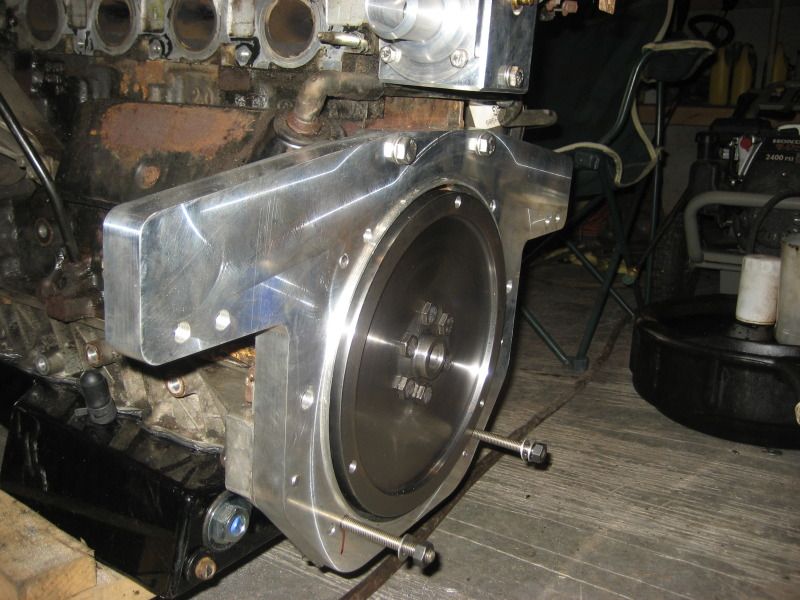

PostPosted: Sat Apr 07, 2012 8:04 am    Post subject: Reply with quote
Zero419 wrote:
I checked the clearance of the TC to the flexplate and the nub on the flexplate was way big by .005 or .010. So I ground the dia smaller and it fits nice now. I was told that endplay of the TC was the major factor in the GT TC failure. I imagine at one time the directions did not include the part where they tell auto owners to do this check and failures resulted.
I think I'll be OK.
Correction.
Bostig guys are reading this thread and pointed something out. I don't want to cause any confusion.
I did not take any material off of the new flexplate. I took material off of the nub (OD not length) on the TC. It is a nice slip fit and there is no slop.
I'm going to make lunch for the boys now and put them down for a nap. (my kids, not the Bostig guys). We went for a parts run and picked up the T-stat gaskets (and local farm milk, butter and eggs). I'm going to continue on the adapter plate and maybe make it to the cooling stuff. I'll have plenty to keep me busy for the weekend between friends, family and Easter stuff. (I should be doing Passover stuff to, but I get along with her family better then mine. Laughing )

PostPosted: Sat Apr 07, 2012 10:38 am    Post subject: Reply with quote
I just installed the flexplate and the adapter. Did the coolant housing and all the stuff that bolts to that (no hoses)
What? that's it? kids are still napping!
Guess I'll have a beer and chill 'till they get up.
Does this mean I have to be sociable this weekend?
Take the dogs to the pond? Have a camp fire with some buddies by the pit?
Well I guess I can run the fuel line, maybe wire the "low oil" light to the dash, install the new TC seal.
Eh maybe tomorrow, maybe Monday. I think I'll slow down if I can, not really my style, but I gotta make time for life.
