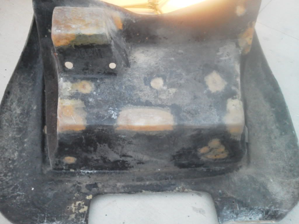

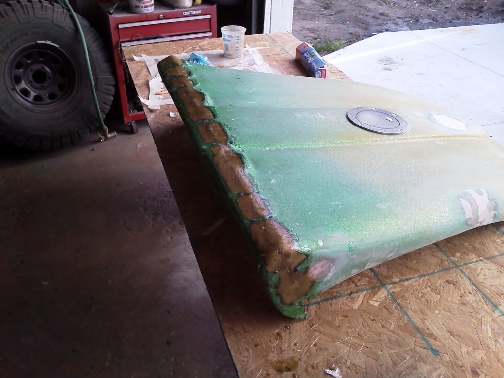

Another useful product to use - before "bondo" - are microbaloons. you mix them with resin to a consistency of peanut butter (AKA "dookie" in boat building lingo) and use that to level the surface. It sands easy and it's the same resin so the bonding is better than "bondo".

That repair looks great. Your not going to have any issues with it.

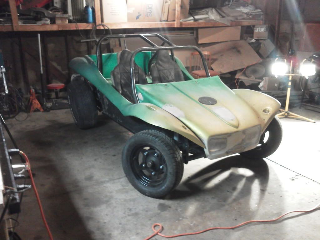

So close.. kinda...

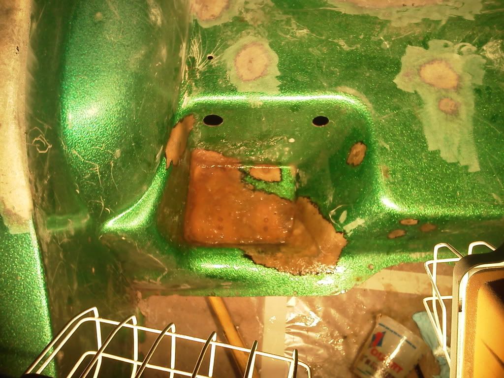

Id like to punch the guy that cut the dash off!
Screwed it together with strips of plywood on the back side...
First coat of fg, going to pull the screws and do the back side next, then one more final over the top.

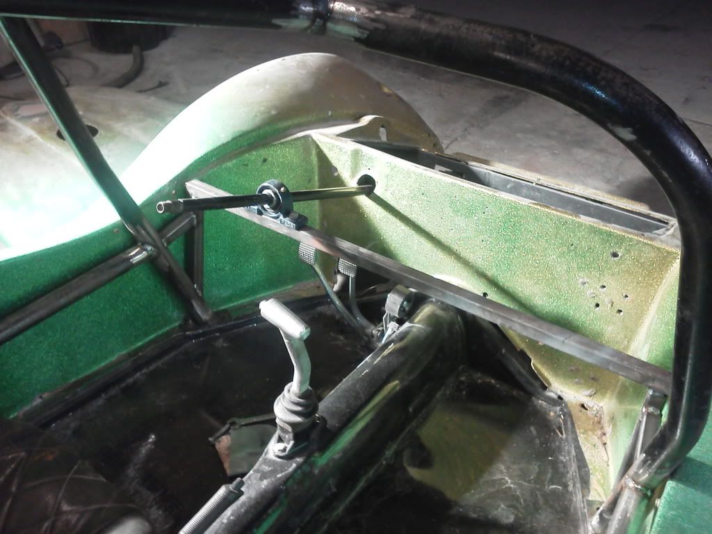

Put a new shift rod coupler and installed an adjuster so I can get it tuned in!

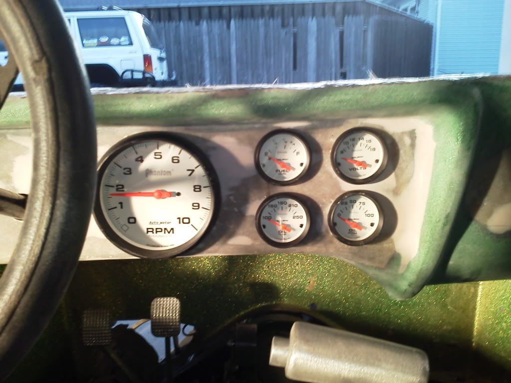

and got my dashed gauges figured out....

I like the gauge placement and choices. The steering column support looks to be good and strong. I made mine close to that design and the wheel did not move around/flex when driving it hard in the turns.

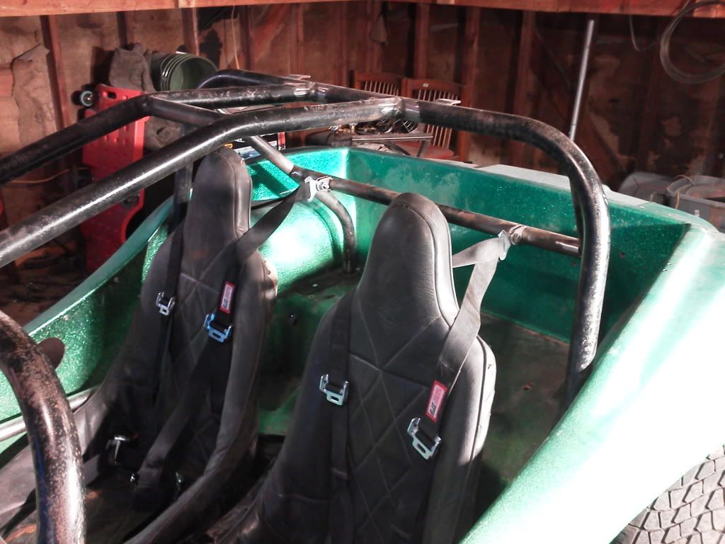

Shoulder belt mounts...

If you noticed I got RJS buggy belts, I ordered them online from a distributor but they are like 20 mins from my house. After getting them I ran into a problem, my seats are so low to the pan and close to my belt mounts that the lap belt was too long! So I went by the company after work Friday and they were super friendley and said they could shorten them no problem. Picked them up today expecting to pay something and she just handed them to me and said no charge! So a little shout out to a great local company that makes great products!
These are where they shorted them, they were originally twice as long.
Heres why I really like these, 3 point belts with simple car style latches.

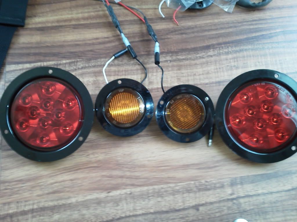

Anyways got my rear lights in, just need to do some FG work to get them in...

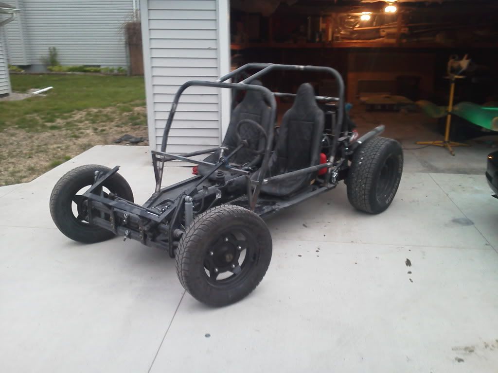

Drove it down the driveway!

Tail lights...
Windshield...
I got the brake and turn signals temp wired up, its tagged and insured so I need to get some mirrors then I can take it for its first cruse!
