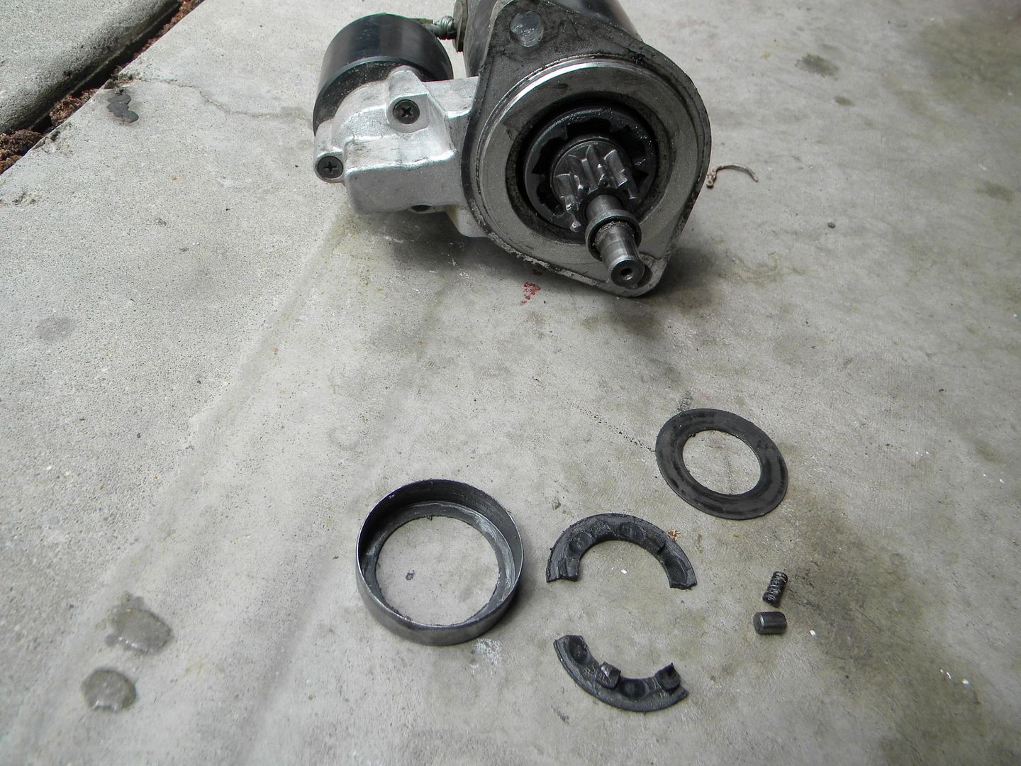

...but wouldn't start after lunch. I pulled the starter out and collected all these parts. I don't recognize the small dowel or spring. Were they parts from the starter? The starter is only 3 years old. Using jumper cables it still spins and the solenoid jumps. Any idea whether this is repairable or do I need another starter? It's a 12v starter from my '67 bug.

Looks like the bearing on the starter shaft belched its' guts out! You will probably have to buy another starter Sad

Just for future reference its not good to spin these starters up outside of the transmission. Without the bushing that is located in the transmission the armature is free to move around and may damage the field coils.

I might be mistaken,but it looks like a disintegrated starter drive;should be able to just put in a new drive?I think the rest of the starter is okay.
Too late now!
